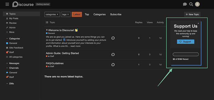

Is there instructions somewhere to modify the looks of the banner?
Also, when I click add to sidebar nothing happens,
ideally I’d just like a simple text link here

Nothing specific to the subscriptions campaign banner, but there are general instructions for styling your discourse instance. I would start there.
It moves it to the right sidebar actually. I don’t know the full history behind it, but probably predates the left-side sidebar being default enabled.
I wouldn’t be apposed to eventually adding some sort of support for a subscribe button/link on the left sidebar though. As an admin though you can customize that section manually and add your own subscribe link.

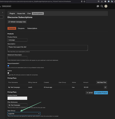

When you setup a product you can choose which group members will be added to when they subscribe:

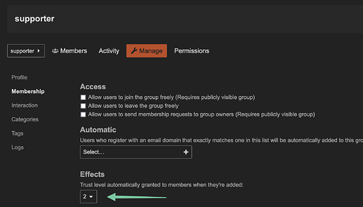

There isn’t anything to bump users to a certain trust level, but many settings now have a list of groups to control what they users can do vs just trust levels, so you might be able to add the group you choose to those settings. Just picking a random setting as an example:
EDIT: Actually you can configure your group to bump a user to a certain trust level

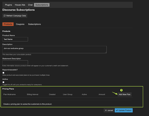

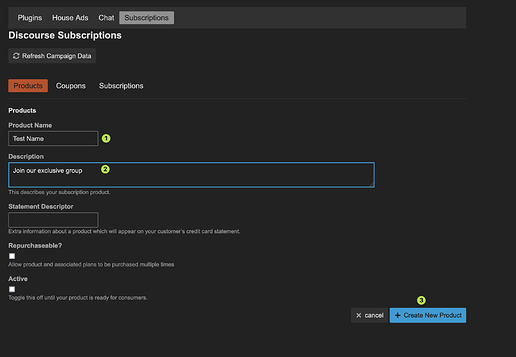

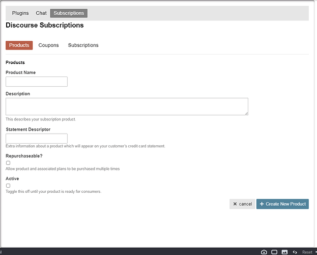

First, be sure you have a group already created that you would like these users to join upon sign up. From the Subscription plugin products page:
Click New Product
Fill out Name, Description, and then click “Create New Product”

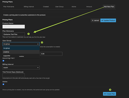

Then this section will appear. Click on “Add New Plan”
And the Plan section will appear where you can select the group. Give it a nickname, select the group, type in a price, and then click “Create Plan”.

You should be able to see/update what groups are assigned to each pre-populated product.
Either way should work. I guess its up to you and what you are after. Some things can’t be easily deleted, so you will need to uncheck the “active” box if you don’t want to use it.
Thanks for your help, I went back to the original products, clicked add new plan but then skipped down to edit the existing products, in that screen it looks like your example, so a lot of new user confusion on my part, sorry to tax you.
