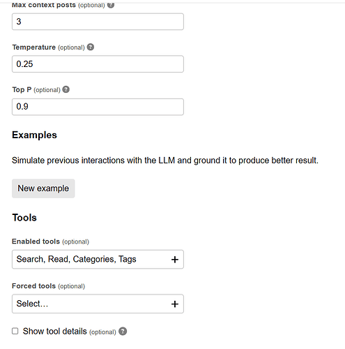

You can add Search as a “Forced Tool” for the first interaction to help ground the model.

Updated the forced Tool as suggested

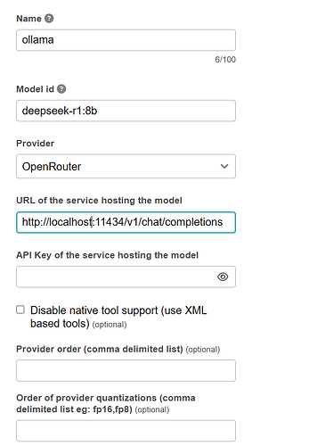

Set provider as OpenAI if you are using the OpenAI compatible API of Ollama.

I have tired with openAI provider still issue is persists.

Can your Discourse container access the service in the port 11434? If it’s running on the host you need to provide a way for the network cross the container boundary.
viswanatha
(P Viswanatha Reddy)
4 Noviembre, 2025 19:33
10
Yes, I was able access one of the LLM model ealier with same port with Discourse container

So it may be
Ah, I got it! The environment variable requires a special syntax in the enumeration—pipes instead of commas.
DISCOURSE_ALLOWED_INTERNAL_HOSTS: “localhost|127.0.0.1|172.17.0.1”
