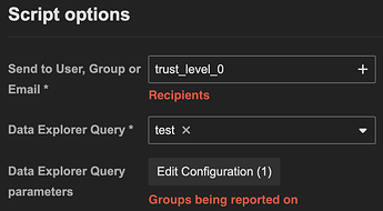

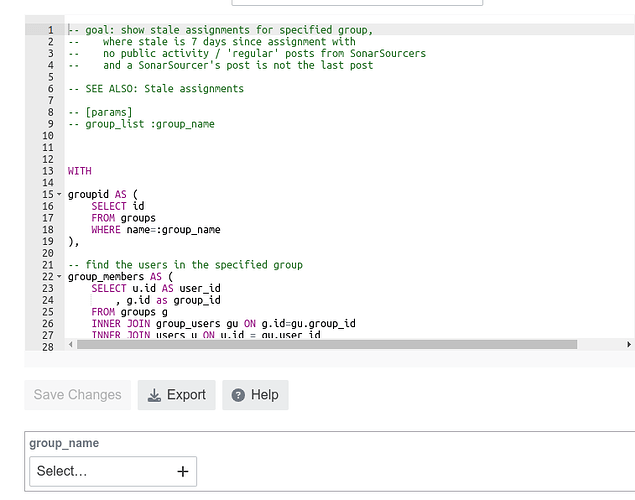

I have a Data Explorer query that accepts a ‘group_name’ parameter
I would like to automate running it for each relevant group and sending the group the results once a week.
But for the life of me, I cannot figure out the syntax to use for the parameter. Here’s what I’m presented for that in a brand new automation:
I find this… unhelpful.
I’ve tried several variations here. When I don’t get an error from my attempts (found in the error logs), I seem to get nothing at all.
If I use a query with no parameters, it runs like greased lightning. How do I make it work for queries that do need parameters?

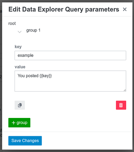

I can reproduce the issue as well.
In your example, let’s say you want to check the moderators and admins groups, you are supposed to have:
key: group_name
value: moderators,admins
Technical stuff to help, don’t mind me. :smile:
