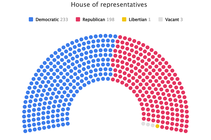

We are launching a forum for our product, whose external embeds already function with OneBox after allowing Iframes from us.
A direct link to an embed, is neatly transformed into the result of our oembed endpoint.
Now, our concern is first and foremost that we would like thumbnails to appear when the Topic List Thumbnails is active. I am not sure why the thumbnail is not picked up.
Would we need to add an integration to lib/onebox/engine?
To add, the default behavior mostly works today, short of not supporting our dynamic embeds. We’d like to load JS instead of an Iframe. Admittedly there is a different solution to this, namely to optionally resize the iframe with some JS, but we are not planning to implement that generically for oEmbeds in the short run.

https://app.everviz.com/embed/N0dDTJaOQ
Will and will not render a thumbnail depending on whether iframes are allowed from the domain (allowed iframes). The solution to this is to somehow inject an iframe to the post. I made a plugin which does so, and makes sure display: none is set on the image, to prevent it from appearing in the post.
