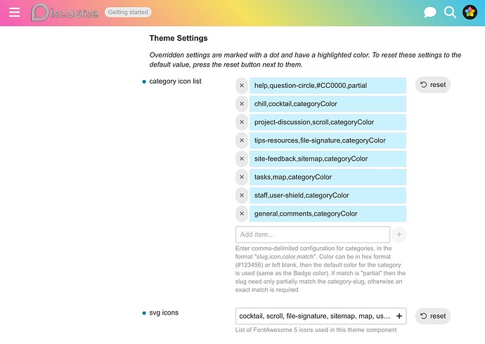

I just got it to work using martini-glass-citrus and cocktail.

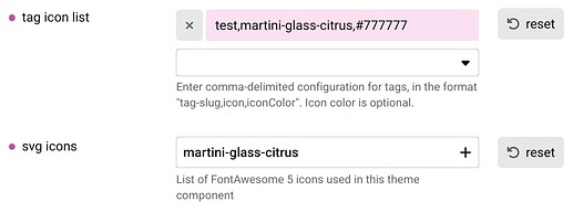

Here are my settings in the Category Icons Theme Component

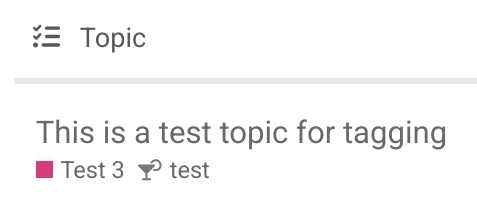

martini-glass-citrus works fine for me as a tag icon

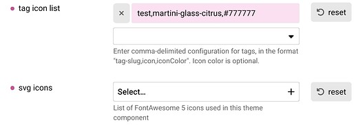

@Lilly @Moin thanks for letting me know – I will try it out. Maybe I had forgotten to add martini-glass-citrus in the bottom field as well.
you shouldn’t have to - see my settings screenshot. shut up Lilly, listen to Moin. see my comment below :innocent:
Then it doesn’t work for me

edit: I got it to work in the Tag Icons theme component
And yes, you do need to put the icon name in the bottom svg-icon setting - @Moin is correct. In my earlier post, having cocktail there meant it was automatically mapping to martini-glass-citrus.
Ok it works for me when i add martini-glass-citrus to the bottom setting. Thank you very much to you both!
