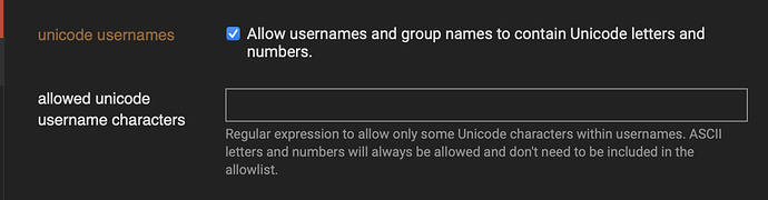

Also what are the values of the settings:
  • allowed unicode username characters
  • unicode usernames
3 Mi Piace
Here are the values (pretty standard :sweat_smile:)
