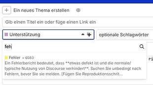

Is there a reason why I can use both Bug and Fehler to filter the category dropdown at latest, but the dropdown in the composer only works with the German word?

However, in reality, both work on /latest, only German works in the selection in the composer, and only English works here when typing in the autocomplete.

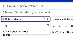

Dropdown in the composer: The real name of the category doesn’t work:
:check_mark: 错误
:cross_mark: bug

But when I am creating a new topic, only the German term “übersetzungen” works
