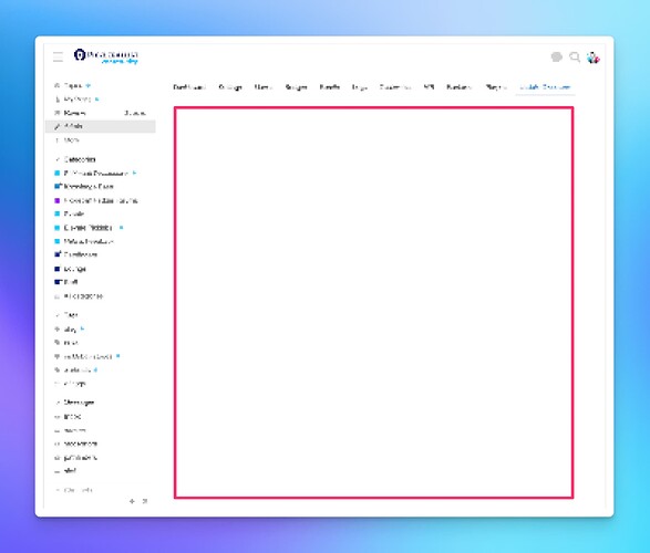

When the completed, from the Admin Dashboard, I again visited admin/update again, only to find that screen was blank within the “Admin/Update” frame.
Screenshot
