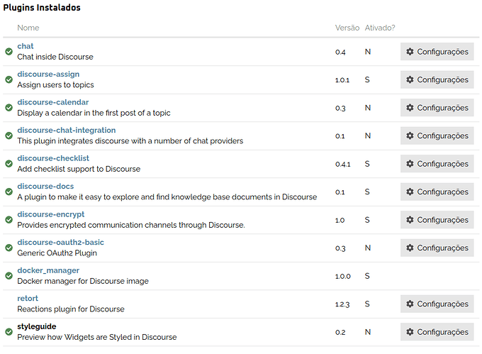

my plugin list, ill disable them all
is there a way to disable all plugins and themes? manually as sysadmin i mean.
Remove plugins from the app.yml and rebuild.
From a quick glance, I’d remove retort, but I suspect your problem is with a theme. JUst use safe-mode and disable all of your theme components in one browser and add them back in another.

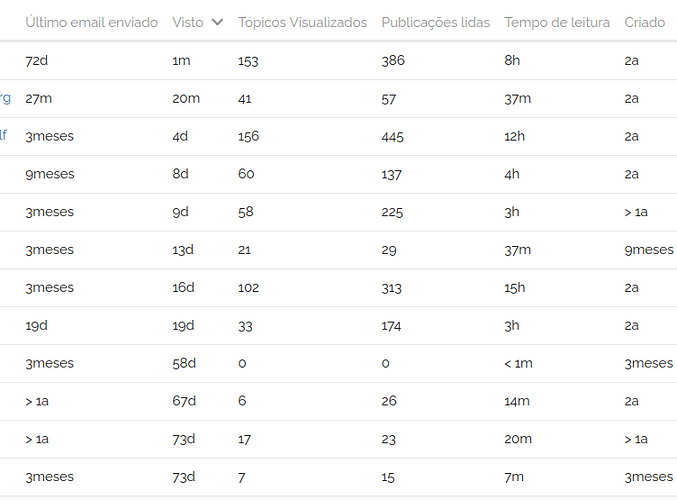

What IP address do you and your users appear to originate from within discourse? Take a look at a few users through /admin
there is no activity at this hour, only me. people use it very spontaneously mostly at the end of the day
There doesn’t need to be current activity for the last IP address on user accounts to be visible.
Open a couple of users via /admin/users and compare Last IP Address
