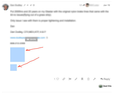

Their posts ends up with extra space like this (blank images are selected to highlight them):
This isn’t really the intent of watched words. I’d look for a different way to accomplish this goal..
