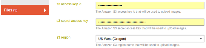

  1. Create an S3 bucket.
  2. Set the s3_backup_bucket in the admin panel.
  1. Configure s3_access_key_id, s3_secret_access_key, and s3_region.
  2. Set backup_location to “S3”.

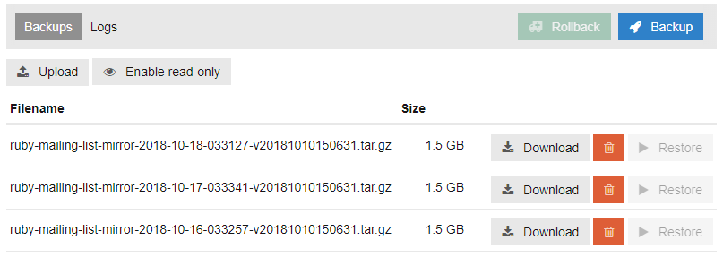

Go to the Backups tab in the admin dashboard to browse the backups – you can download them any time to do a manual offsite backup.

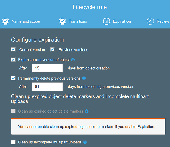

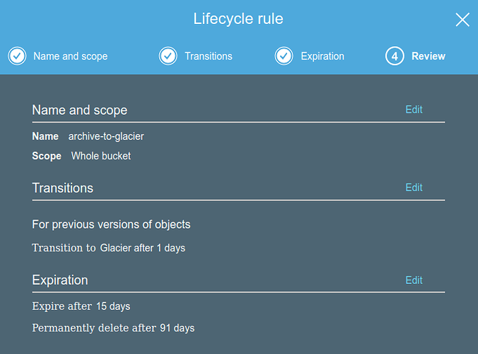

  • Add a rule for the whole bucket
  • Set current version to expire after 15 days

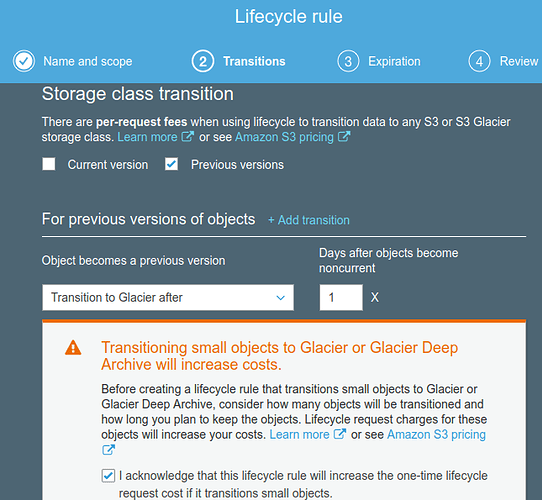

  • Set previous version to
  • Archive to Glacier after 1 days
  • expire after 91 days
  • Save and logout
How it works
Versioning will keep backups automaticly deleted by Discourse. One day after beeing deleted it will be moved to the Glacier storage. After 91 days it will be delete from the Glacier storage.
