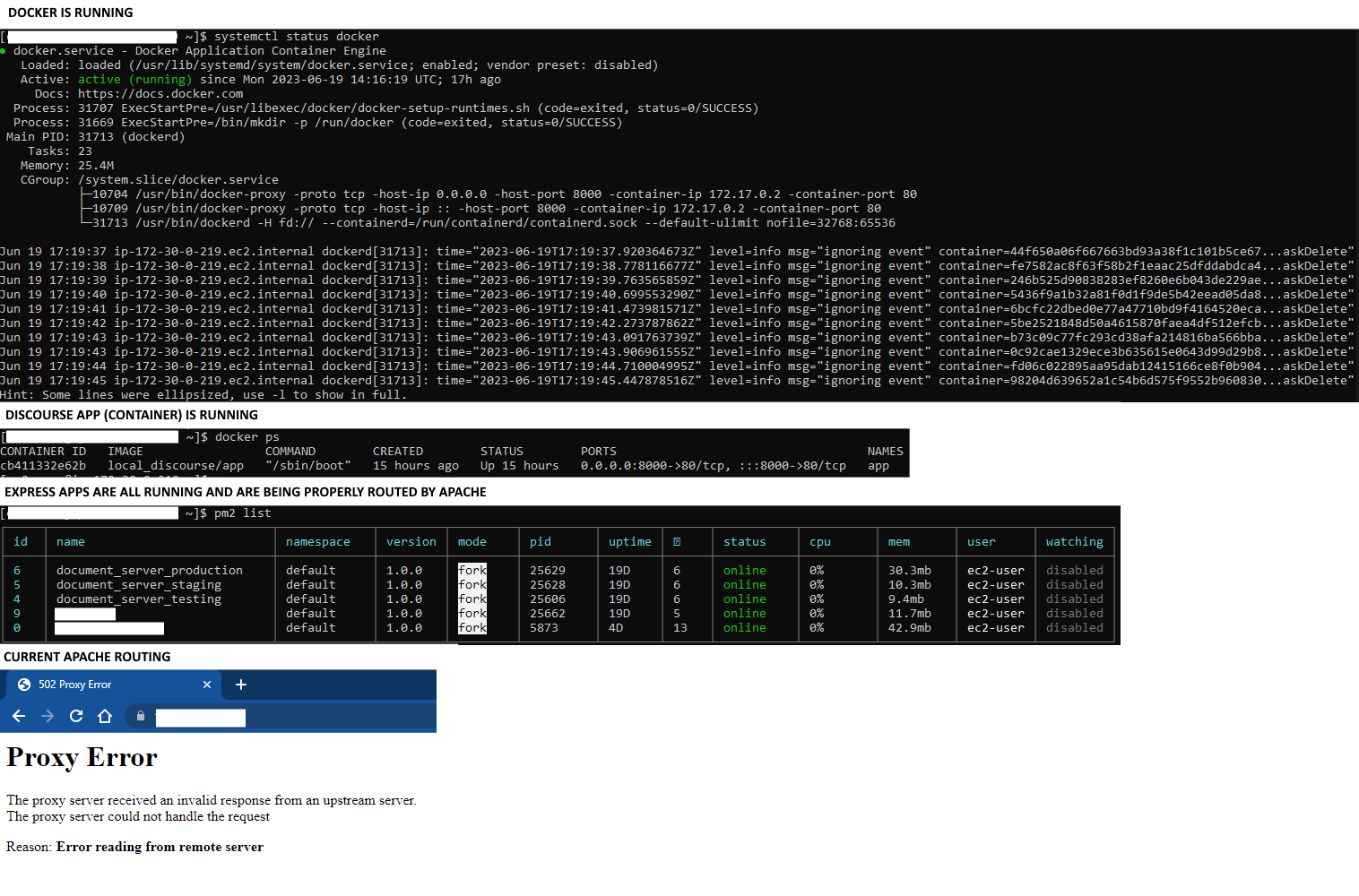

Current status:
  • Docker is running
  • The discourse app (container) is running
  • The express apps are all running and are being properly routed by apache
Notes:
  • I tried running building the app initially without exposing the ports per the documentation, when that didn’t work I did expose port 8000 over http port 80;
  • In my simple understanding docker is like a house and the various containers are the rooms. Docker determines how the app is accessed i.e. which room to access. My thought by exposing port 8000 was that I could then reference port 8000 as I do with my other express apps now that 8000 was exposed. But this does not work, below is an example of what I tried to do in apache:

Currently I get a 502 error in chrome when I try to navigate to my discourse docker container. (See above screenshot).

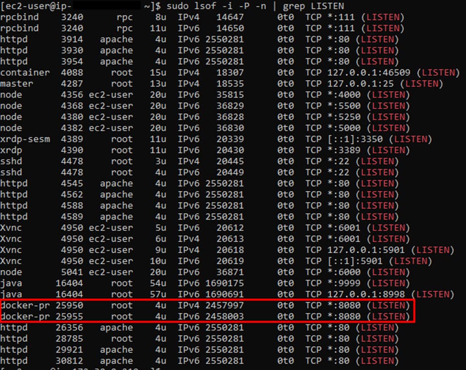

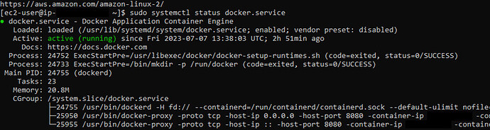

INSTALLATION OF DOCKER AND DISCOURSE ON AWS EC2 LINUX WITH EXISTING HTTPD REVERSE PROXY
Hi All
I have figured it out. I went back to the drawing board and started fresh with clean docker and discourse install. My process is detailed below:

  1. Enable docker service to start automatically on boot by running the following command in the console / terminal
$ sudo systemctl enable docker.service
  1. Start the docker service by running the following command in the console / terminal
$ sudo systemctl start docker.service
  1. Check the docker service is running by running the following command in the console / terminal, the output will look similar to this

  1. One your app has been rebuilt the app should be running on port 8080. To verify this run the following command in the terminal
$ sudo lsof -i -P -n | grep LISTEN
Example output of ports
Notice docker is listening on port 8080, httpd (apache) is listening on port 80.
In terms of traffic routing apache will receive the web request and where appropriate will be routed to the discourse container on port 8080.
To make sure the routing happens you must configure the virtual host in the apache conf file.
