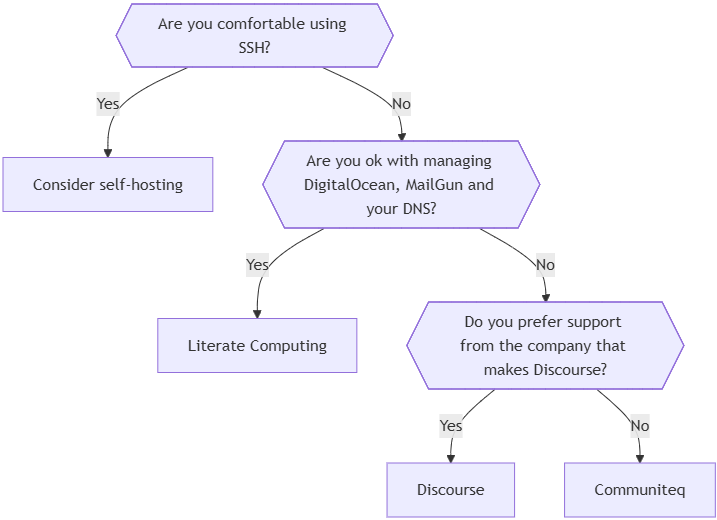

I found this decision tree also pretty helpful, maybe it’s outdated so if some of em are easier now pls lmk
5.1) I don’t quite get what SSH is, & as per this graph do all self hosters need this?
5.2) What do they mean by being ok with managing DO, MailGun & DNS? What kinda time/time & knowledge level does managing these entail for my kinda forum?

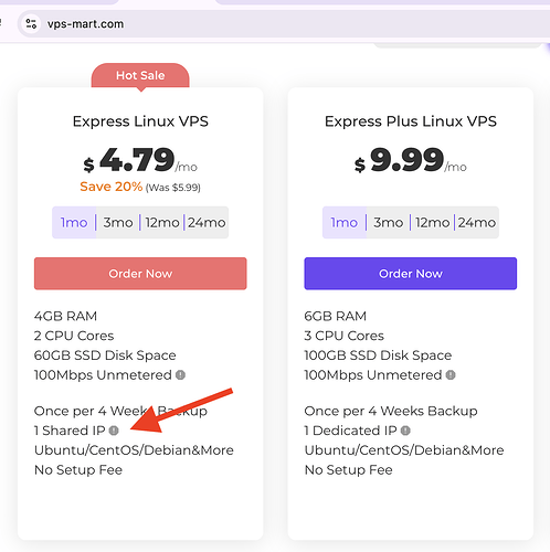

5) Does DO/Hetzner provide a significant difference compared to a very cheap (but ofc must be legit) vps? fr eg these: IONOS VPS Hosting | Virtual Private Servers | Starting at $4/month
vps mart VPS Promotion 2026, Starting at $1.04/month
Interserver’s $3/m for 2GB RAM

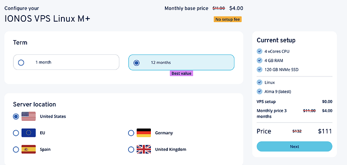

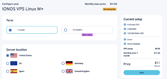

on IONOS VPS Hosting | Virtual Private Servers | Starting at $2/month i see that the $4/month config requires a 12 month term and no details about IP, so it is important to really read the terms of what you are wanting (i also notice they offer Plesk, which you don’t want :face_vomiting:) :

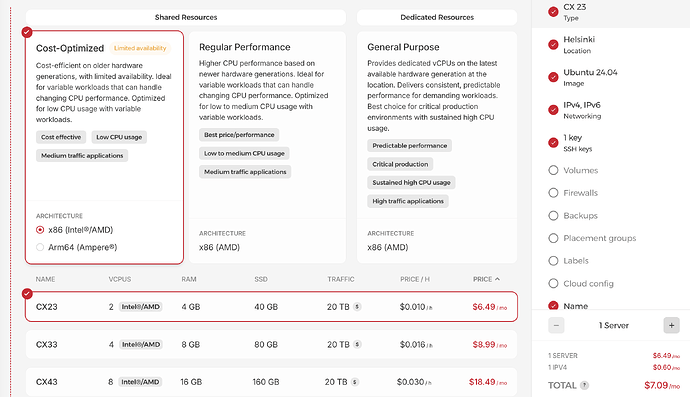

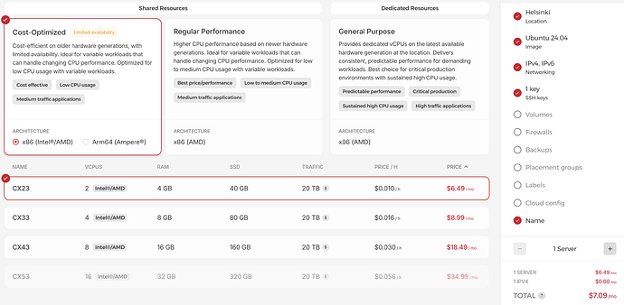

this is the current Hetzner costs for similar Linux config that will work for Discourse, and it provides dedicated IP and root ssh access:
what is also great about Hetzner is if you just want to test or try, you can rent servers by the hour:

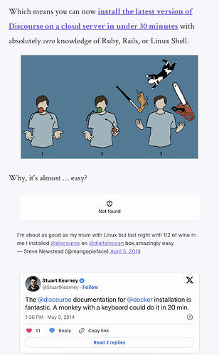

I think the simplest way to find out is to follow the Discourse official 30-minute install guide for self-hosting on Digital Ocean:
The first time I followed these instructions, I had little or no prior experience before in setting up DNS, SMTP, SSH, but I was able to successfully set up a forum right away. now I find these straightforward after doing it many times.
If you don’t end up using that forum, just delete it after.
And if you run into any issues, you can feel free to ask on this support forum and there’ll be lots of exisiting info to help you here too.
If you find these steps manageable, then you should be able to self-host. If it’s too difficult or time-consuming, then you’re probably better off with managed hosting.
Sometimes it’s easy to overthink too much, when just trying it out will help answer a lot of your questions instead too!
I was encouraged to try it out after seeing this official Discourse blog post:
