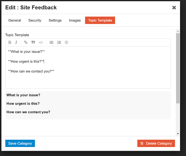

This is possible. You need to first prep your category with a topic template. Go the category you want to use and edit its topic template like so:

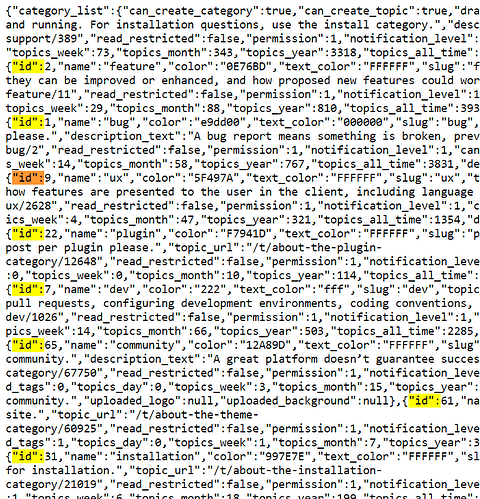

Then find out what the id of the category is. You can do this by going to your.site.com/categories.json
Here on meta it looks like this:
There’s probably a better way to find the categoryId but this works as needed here.
Now, let’s say I want to use the bug category. The Id for it would be “1” based on /categories.json
For feature, it would be “2” and so on.

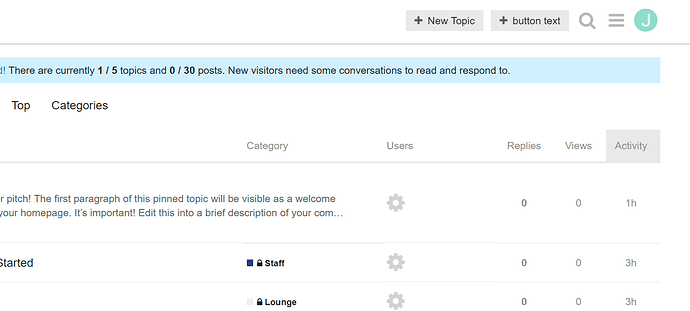

This goes into the </head> section under Common.
Once you’re done, you should have something like this: (I added margins with CSS)
Clicking the new button will open the composer with the category you selected and the topic template for the category will be present as well.
