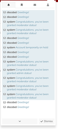

Hello all! I have a question brought up by one of my users. They just signed up, and appeared to have many notifications, however trying to go to most of them gave them a 404 error. This is to be expected, since 99% of the notifications they see aren’t meant for them.
Here’s a screenshot of a test user I have on the site (level 1 user, never been suspended nor a moderator):
Any ideas what could be causing this? Probably a misconfiguration on my end. I thought it was maybe because the reverse proxy wasn’t sending individuals IPs correctly, but I’ve checked and no users have a registration nor last login IP of anything that would be local to my network, so that’s working as expected. Also, dismissing notifications doesn’t work, even though a HTTP 200 is returned when clicked. Any ideas are appreciated!

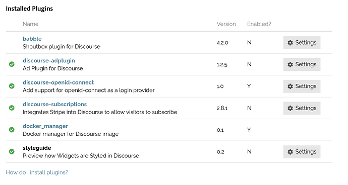

Can you share your list of plugins?
Sure thing:
The only two I still have enabled is my SSO (we use a mix of native and SSO signins, this issue is present on accounts linked to our SSO or not) and the docker manager I cannot disable. The rest are present, but have been disabled in an attempt to rule them out.
Babble is not maintained anymore. I would uninstall it completely (ie remove the clone from app.yml and rebuild)
