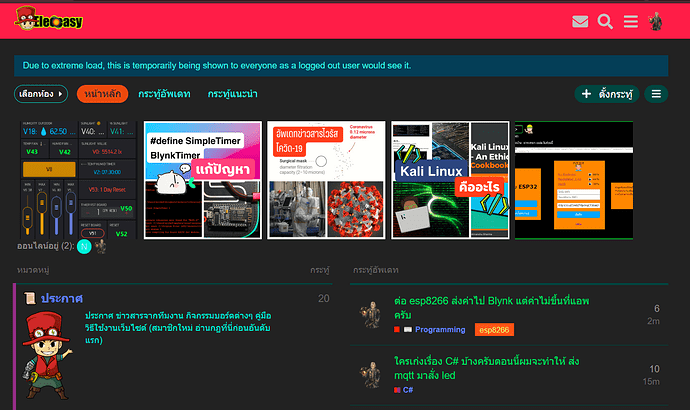

We had a surge of new visitors this morning due to a popular AMA and many people received this message which was somewhat understandable since one topic was getting overloaded and the cpu spiked during this time. Since then it has subsided but I keep getting this error telling me I’m logged out then it refreshes and shows the warning message.
FYI I have 2gb memory and 1 cpu on DO. There were about 30 users online this morning when it first happened and now there are only 10. Do I just need more CPU power or does this seem a bit odd that it keepshappening?

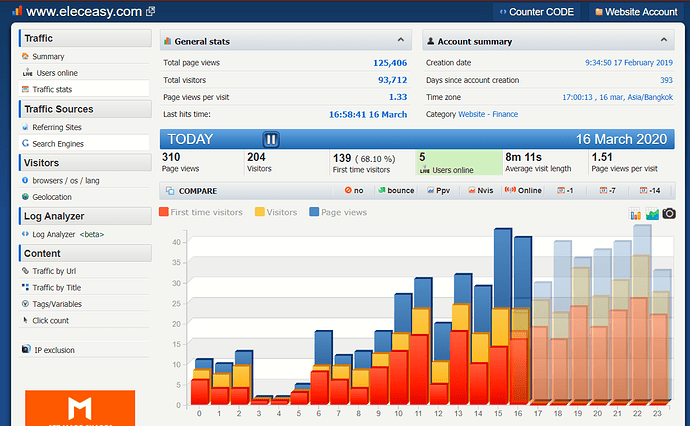

I has same problem
Use online 5
My server
