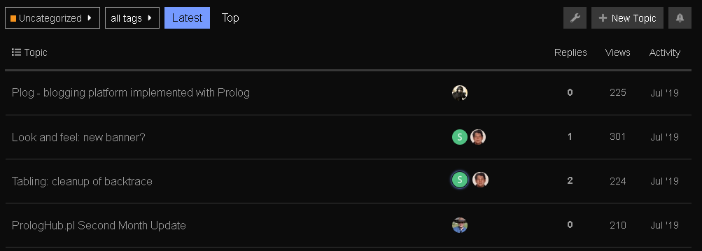

Thanks to those who responded. This is what I discovered/performed.
From the main page https://swi-prolog.discourse.group/ click the browser refresh button.
Click Categories
Click on Uncategorized
Click image
Scroll down so that all topics show in list. Topics not visible can not be selected so they all need to be visible. Hopefully you don’t have thousands.
End of page should show image
At top of page click image
Click image
Notice the number of topics selected, make sure the number is correct.
Click image
Change category
Click image
The progress will be shown.
