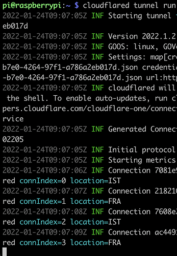

I am using this command as pi user
cloudflared tunnel run <UUID or NAME>

When use this command as a pi user cloudflared tunnel list
You can obtain more detailed information for each tunnel with `cloudflared tunnel info <name/uuid>`
ID                                   NAME      CREATED              CONNECTIONS
371dd57c-**************** ze****2022-01-24T03:35:19Z
It is normal?

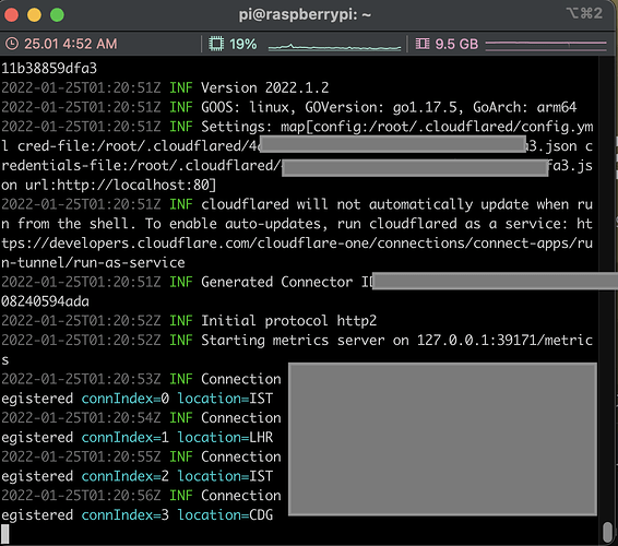

Somehow I finally ran the site on Raspberry and it’s live.
I don’t really understand how. I am removed Cloudflared and re-install it with root user. And it works…

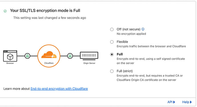

I have two questions,
1- It seems my SSL certificate not work correctly so I can’t login to my admin account on Discourse. (It appears to be running in incognito tab. Maybe it’s something about cache.) Are you using full or full(strict)?
2- I have questions about running cloudflared as a service. https://developers.cloudflare.com/cloudflare-one/connections/connect-apps/run-tunnel/run-as-service
I ran tunnel with cloudflared tunnel run <UUID or NAME> command. But when i close the iterm windows will it stop working?
If you have already logged in and have a configuration file in ~/.cloudflared/ , these will be copied to /etc/cloudflared/ .
If you do not have a configuration file, you will need to create a config.yml file with fields listed above. You can pass a custom file by running cloudflared --config CONFIG-FILE service install .
I checked, i don’t have configuration file in /etc/cloudflared/. In this case, what should I do to run this service automatically?
Thank you.

Hey @bekircem,
I think reinstalling it would of fixed the issue of cloudflared not finding the certificate…
With regards to running Cloudflare as a service - the configuration file you created when running the service manually will need to be moved to /etc/cloudflared.
I’m unsure about linking personal sites here so please let me know if I need to remove this but I’ve covered this under my one of my blogs under the section called: ‘Setup and Run Cloudflared as a Service
Let us know how you get on!
Alex.
