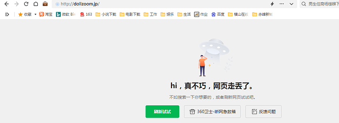

My forum is suddenly not connecting since this morning. After a ping query, my domain is still active. What exactly is causing my forum not to be connected for use?

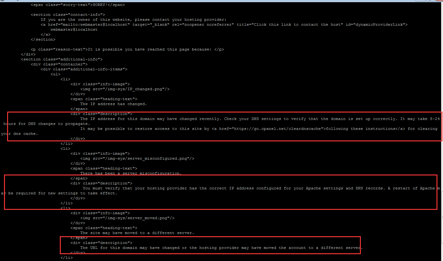

Then we check apache, there are processes, systemctl stop httpd stopped apache prompted to find the page.
We start apache again
Then check docker, there are processes, systemctl restart docker restarted
This last one is the docker restart still doesn’t work error

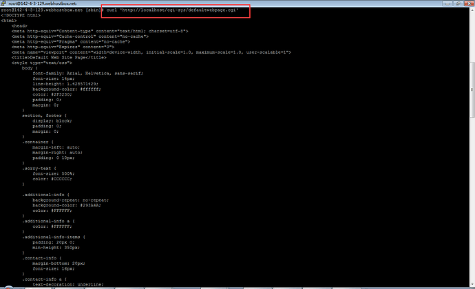

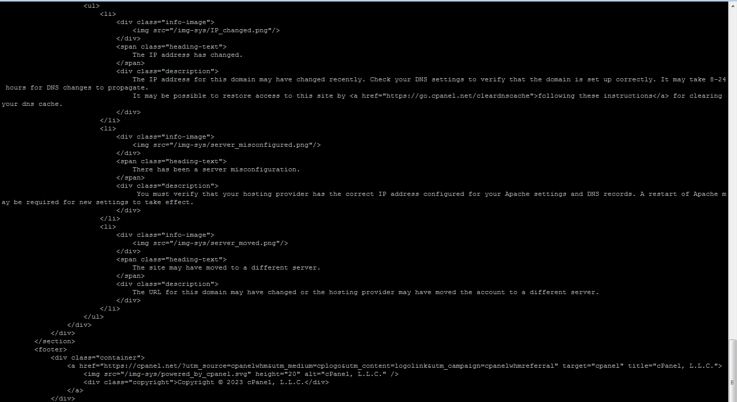

Finally, on the local machine, using localhost without a domain name, it still gives the error
curl 'http://localhost/cgi-sys/defaultwebpage.cgi

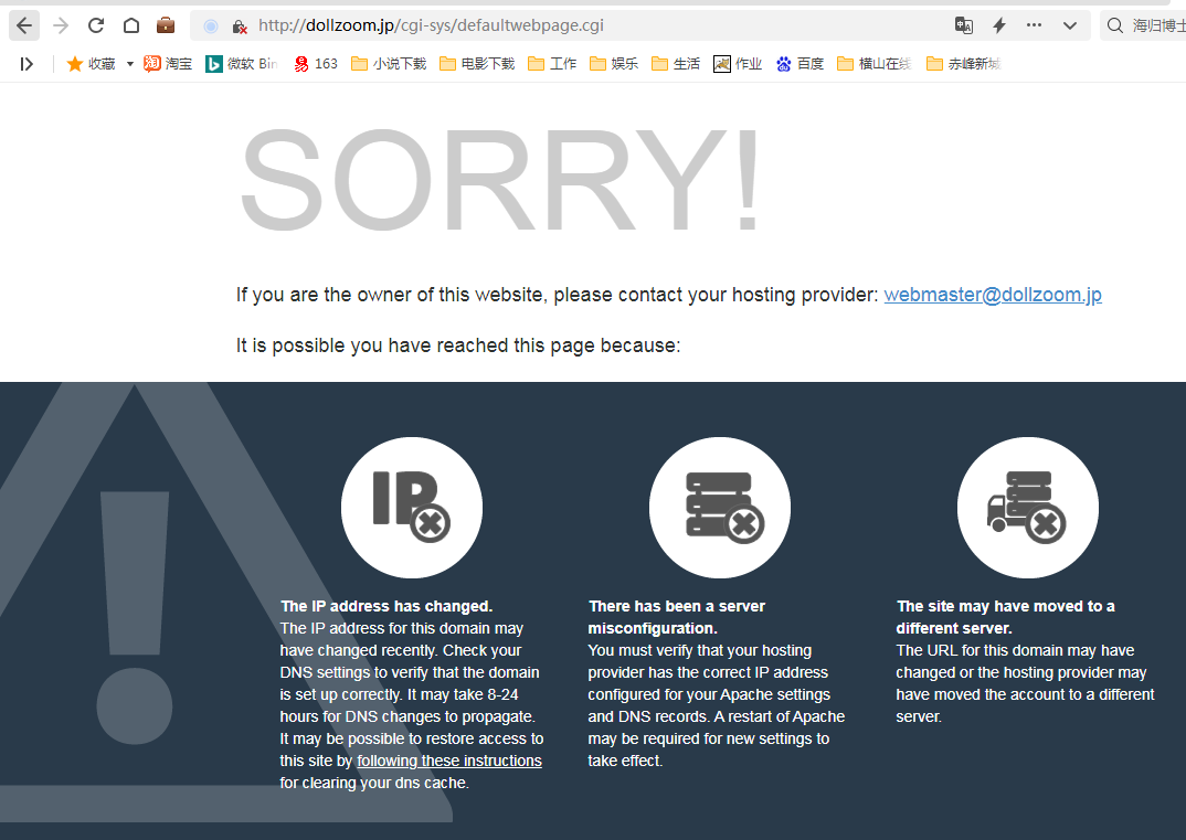

Confirmation now is that there just doesn’t seem to be a dns setting.
Was the dns removed? Or was there no dns setting from the beginning?
Now the server provider reply is "
We tried to log into your VPS and viewed that there is no website data on this host, please contact your site builder to confirm if there has been any operation to remove the site or if Wangzhan is stored on another server."
But my friend never did anything more after finishing the installation for me. We also don’t make changes to systems we are unfamiliar with as long as they are working properly.
It was strange to test today and find no dns. What should I do to set the dns?
Is the reason I can’t connect to the site this time because the dns isn’t set?
You’ll need to ask your friend what they did. It’s impossible to tell how they installed our what the issue might be.
How is your DNS set up?
That would depend on who provides DNS for your domain. Different service providers have their own way of doing it. There’s nothing unusual about DNS for Discourse. You just need to point the hostname you want to use to the server IP address you’ve installed Discourse on.
