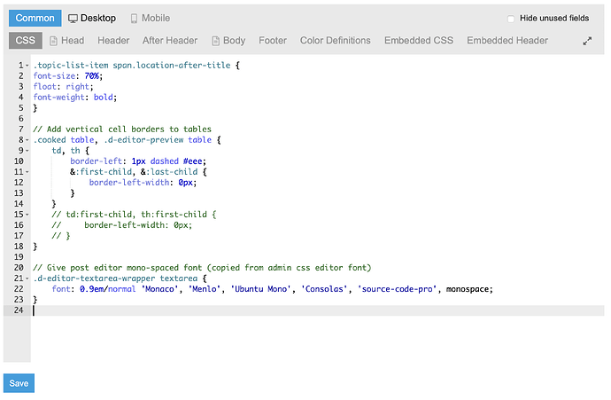

You have already beautifully implemented this for css in the admin styles editor:

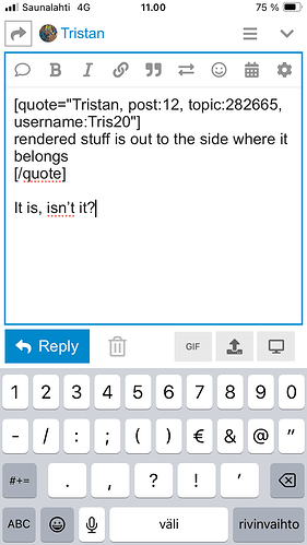

It is, isn’t it?
These editors are made for devs and coders and are really confusing for ordinary ones.
But it is what it is and is too deep in the core to change. Like draft question :wink:
Anyway — off topic etc.

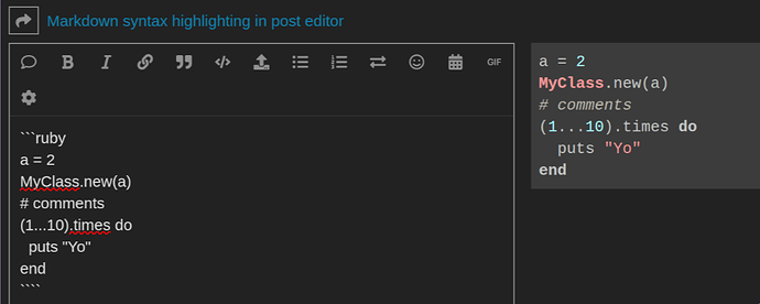

This infra also makes it possible long term to apply syntax highlighting on markdown if we want to go down that path, it becomes a lot less necessary though with the new composer.
For example the new composer now allows you to apply syntax highlighting to code while you are typing it!
