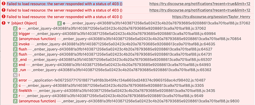

There’s no error popup, nor anything in the /logs that I can see (even with verbose logging). There’s nothing in the browser console from the initial logout attempt, but errors start after subsequent logout attempts (trying to logout when I’m technically already logged out):
