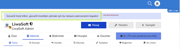

Hi all.

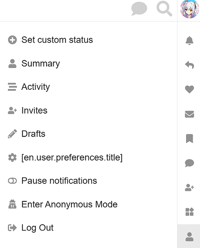

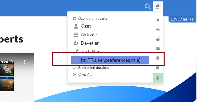

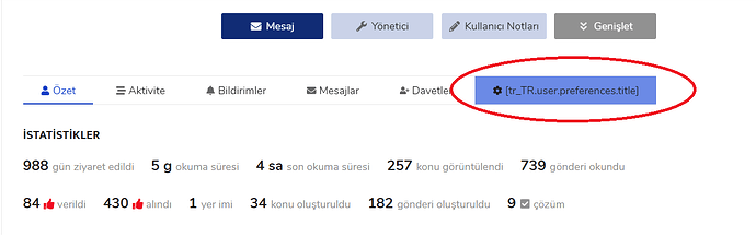

With the update I made about 1 week ago, a button display problem appeared on the user profile page as follows. I thought it could be fixed with the update to be made in the following days, and although I made the ongoing updates, it did not improve.

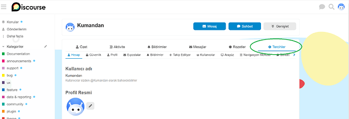

Does the text work on your profile here at Meta?
Have you customized the string in the past?
I also found this topic Turkish translation issue with share dialog so maybe try a rebuild.
There doesn’t seem to be any problem in meta. But the problem persists on my own site. I didn’t do any customization/localization.

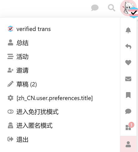

I think this is related to
I was able to reproduce the issue that the string for preferences in Turkish was broken. I customized js.user.preferences before updating and after the update the new js.user.preferences.title was broken.

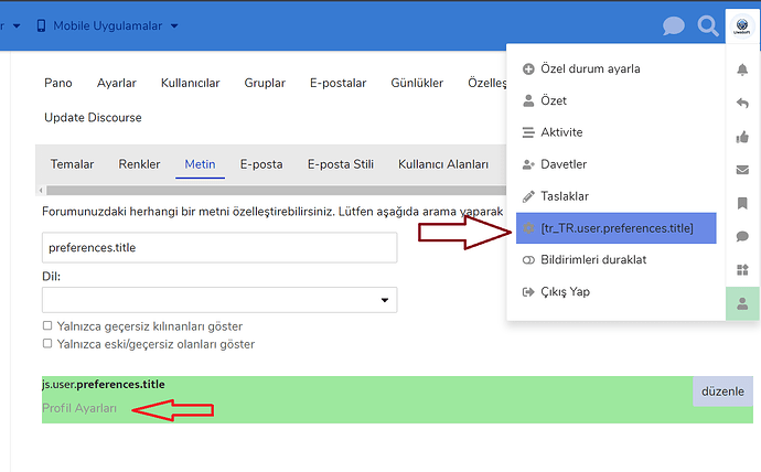

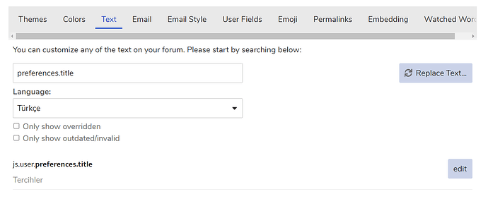

When I check, the text value appears correct.
I changed the default text but it still didn’t work and the same problem persists.
Is it safe to do this in a production environment? Can someone guide?
No text customization works on the forum. It doesn’t just apply to this area.

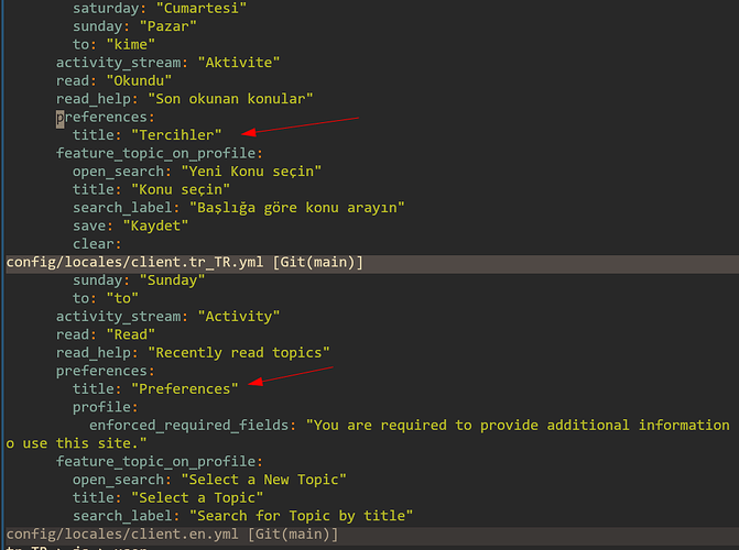

The forum I manage has an override for the translation js.user.preferences. Before this commit, it was a string, so the translation override worked fine.
After this commit, the key becomes an object. However, the translation override does not detect the key type, but directly overrides it to the old defined string. This causes the translation of the key to be missing in the interface.
