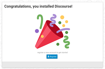

Confirm that your install is working:

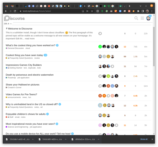

EDIT: and for kicks, I tried this out on a recently installed test site; I pasted in your bundle and rake tasks and it did this:
root@test2-app:/var/www/discourse# ALLOW_DEV_POPULATE=1 rake dev:populate
OK
I did no detect a custom `config/dev.yml` file, creating one for you where you can amend defaults.
There are 9 group records. Creating 6 more.
There are 3 user records. Creating 27 more.
There are 4 category records. Creating 26 more.
discourse-solved enabled on category 'Recipes' (12).
Creating 30 sample tag records
There are 6 topic records. Creating 24 more.
