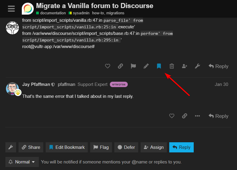

I bookmark the topic itself using the topic actions:

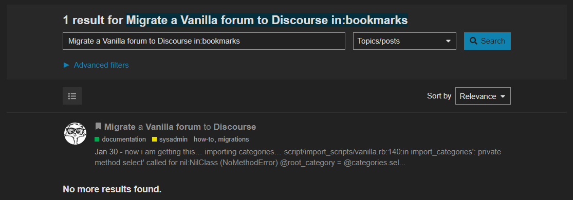

The search with in:bookmarks returns nothing:
The search with in:bookmarks in:title returns nothing as well:

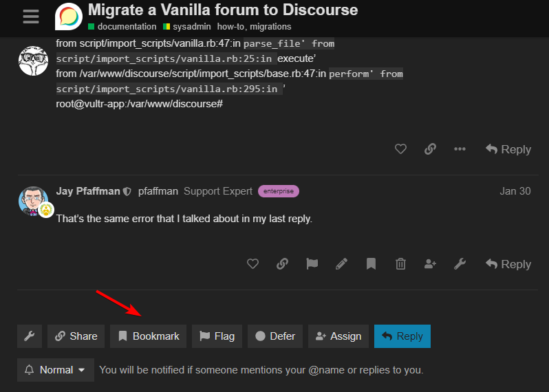

Now, I remove the current bookmark, and bookmark a post from this topic instead:

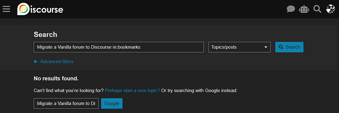

The search with in:bookmarks returns the topic:
The search with in:bookmarks in:title returns nothing:
