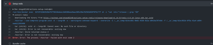

Trying to submit a plugin, I’m getting this failure on untarring redis.
Maybe --long=30 is the issue? I’m not quite clear how to try to debug this…
I think the error is saying that it can’t execute zstd. Do you have that package installed?
No. Perhaps something changed in the base Docker image, or the OS that it’s created with and it needs to be added there. I’m really not clear where that should happen, but I’m pretty sure that it’s not in my plugin. :man_shrugging:
The zstd requirement is coming from the redis package (downloaded in your screenshot) being compressed by zstd. If zstd wasn’t required before, potentially the compression method changed on the shogo82148/actions-setup-redis side.
If you are using our base image, you shouldn’t set up any Redis, as it’s already there.
I always try to do everything your way. :wink:
I’m using the base image and process described in:
It worked last week. There isn’t a new commit in those workflows in 2 months. I don’t think there’s anything that I could have done in my plugin to break this in this particular way.
That process was updated Sept 15th to remove that Redis action, wasn’t ?
That’s it! Is there some recommended/easy way to not let this happen and look so foolish?
