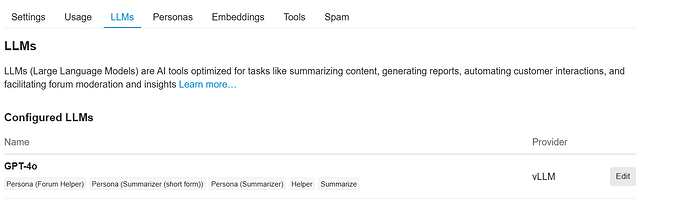

Then I related the Summarization Personas (Smmmarization and … (short form) with this LLM and activated the Topic Summarization.
What I´m seeing now, though, is not what I wanted to see :smiley:
And that´s not changing :frowning:

Why is the provider set to vLLM if it is an OpenAI compatible endpoint?
Hi,
I´ve tried many different engines. Sorry, the screenshot was misleading. I´ve tried OpenAI also …

Hey guys,
The translator and Forum Helper are working now, but the Summarize Button doesn´t trigger anything.
I´m not seeing anything in my CloudWatch logs that any request has been triggered from discourse.
The summarizer is configured with the Summarize Persona, and the Perso is using the LLM endpoint which I meantioned earlier in this discussion …
Any hints ?
Many thanks and Greetings,
WS
New insight:
Some topics can be summarized, some not…
It seems that the new ones can be summarized.
And another question: When I have a topic with pictures in it, and don’t have any image-recognizing AI in place, is this a problem?
That is a 502 from your own endpoint :stuck_out_tongue:
Topic length maybe?
It will be for image related tasks, like image caption or post triage automation.
Hey @Falco
But discourse even start the request, nor gives any reason (logs, …) why it doesn´t :frowning:
Hard to narrow down my options
No, it wasn´t´. I found the problem (didn´t JSON.stringify the body from llm endpoint, but discourse could be a bit more talkative about the reason for this 502 :slight_smile: )
Thanks and cheers,
WS
