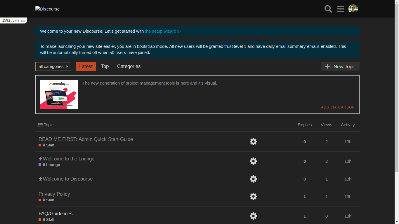

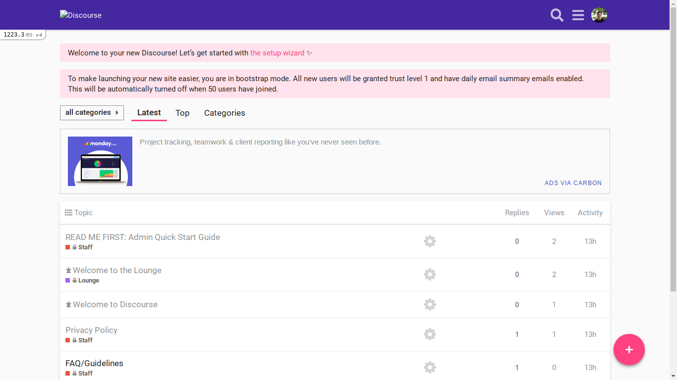

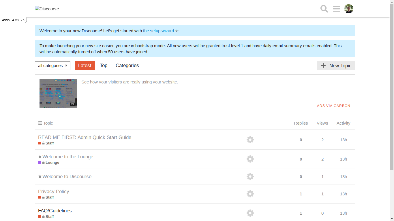

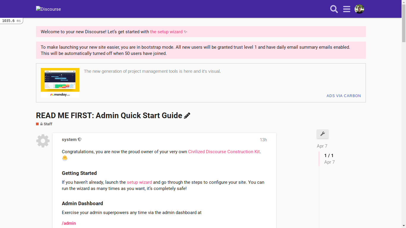

I’ve finally gone for the plugin way, and opened a PR to add Carbon Ads to Discourse-AdPlugin:
https://github.com/discourse/discourse-adplugin/pull/73
@codinghorror is using Carbon Ads on his blog, so I’m inclined to approve your PR and include it in our official plugin. I’ll review.
PR is merged. Thanks @barreeeiroo.
