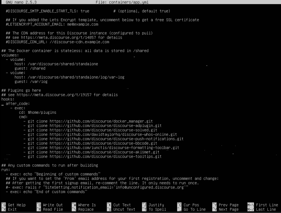

You might try without the discourse-formatting-toolbar
Yes, I removed that plugin along with the rest, but unfortunately, the issue persists.
After stripping down almost all the plugins, I’ve appended the latest output from running ./discourse-doctor, and the problem remains. I wonder if I should also consider removing some of the templates or if the error might be elsewhere. Everything was functioning smoothly until I attempted to update, and now the site is down. Here’s the additional text from the ./discourse-doctor output, which may shed more light on the issue:

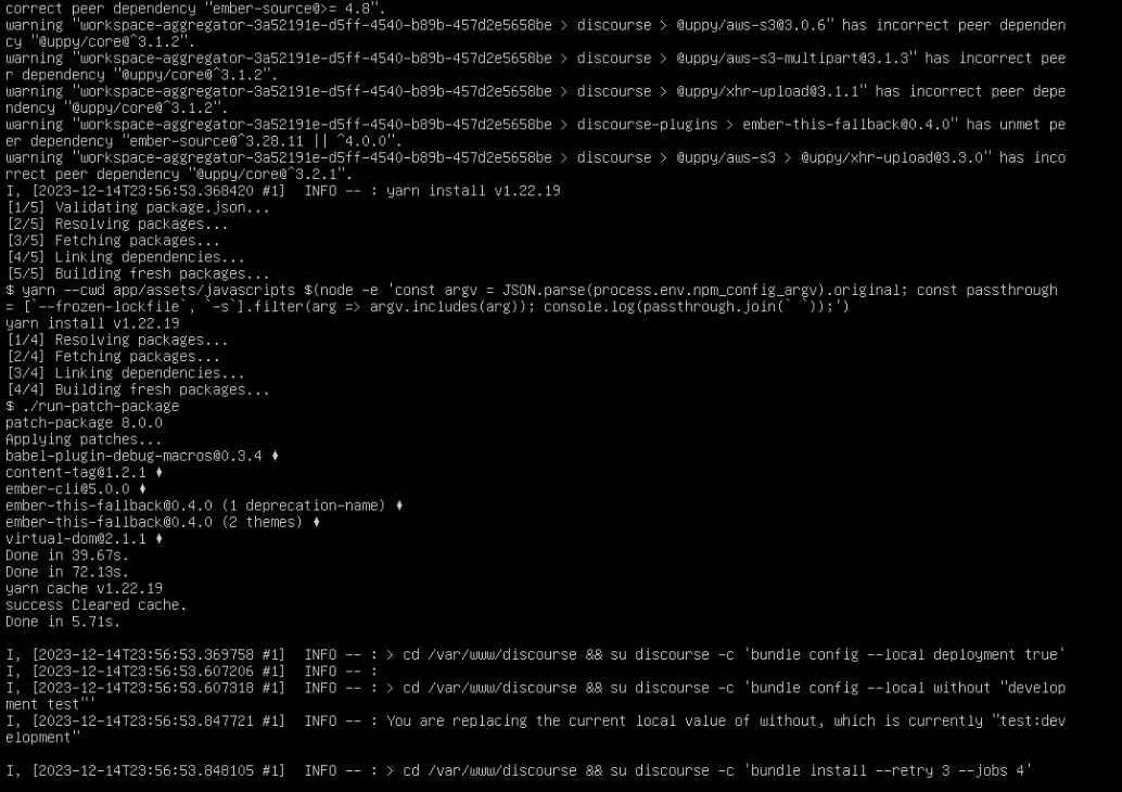

You need to share the first part of the build log. The part that includes the bundle install line.
Do you mean this part? - sorry, moving around and seeing all the code with the DigitalOcean console is very difficult.
Could you look through the long and provide places where there are errors? The one at the end shouldn’t be the only one.
If that’s too much of a pain, providing the whole log works too.
Looks like this was the critical fail:
I, [2023-12-14T22:38:19.544278 #1]  INFO -- : > cd /var/www/discourse && su discourse -c 'bundle install --retry 3 --jobs 4'
