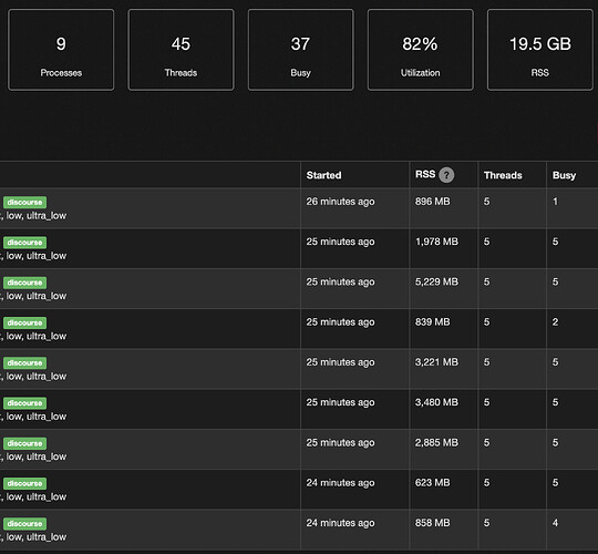

also:
Sidekiq is consuming too much memory (using: 3570.19M) for 'www.example.com', restarting
This is using the all in one app.yml with Discourse stable 3.3.2.
From the app.yml:
UNICORN_SIDEKIQS: 9
DISCOURSE_SIDEKIQ_WORKERS: 5

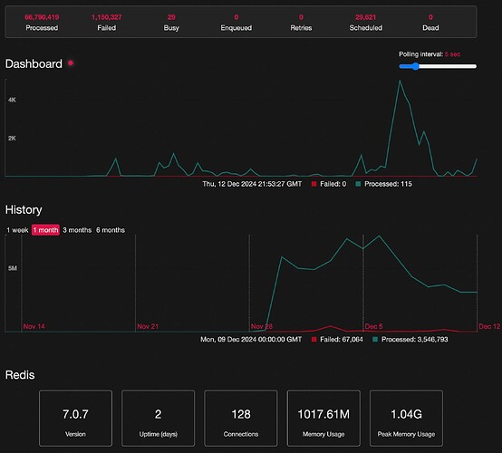

I added this configuration to the host also:
Sidekiq dashboard info:
It does seem like Redis is not able to surpass 1024M memory usage.
