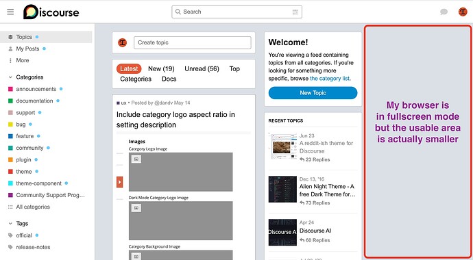

how to fix blank area on right.. is that from my mac or theme?

do you mean to the right of the image? I believe you’ll have to increase the site setting max image width from admin/site_settings — though note that this will only change new uploads, if you wanted to change the old ones the posts would have to be rebaked (Rebake all posts matching a pattern).
if you mean the post width itself, that’s just the theme… I might try to add some content there in the future

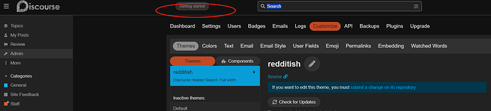

Seems the geting start doesn’t work. Could you please fix it? Thank you very much!! :smiley:

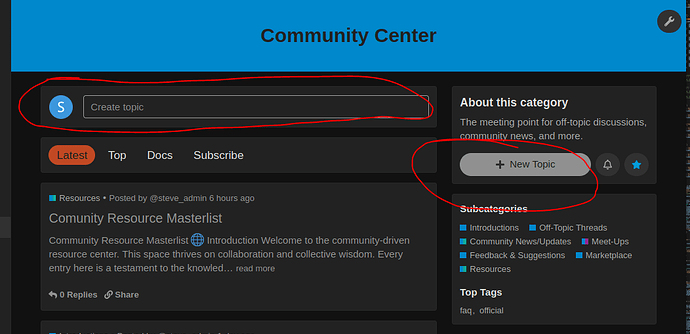

@awesomerobot This is an awesome theme! I really like it however I can’t seem to be able to create a new topic via the ā€˜Create Topic’ textbox, nor the ā€˜+ New Topic’ sidebar.
I cannot see any other comments that show others experiencing this issue so not sure if this is common or not? Does it work fine for you?

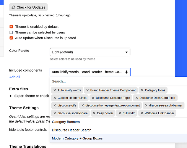

The components I’m using are:
Whether or not the components are causing the issue I’m not sure - I did remove all then try again and still had the same error upon clicking New Topic. Quite strange :thinking:

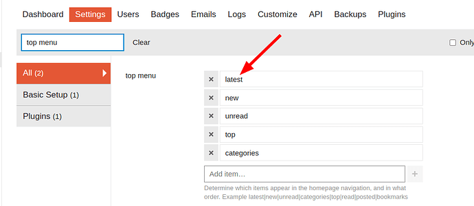

I think what you are wanting to do is set /latest as your forum’s homepage. If that is correct, you can do that by setting latest as the first item in your top menu site setting:
