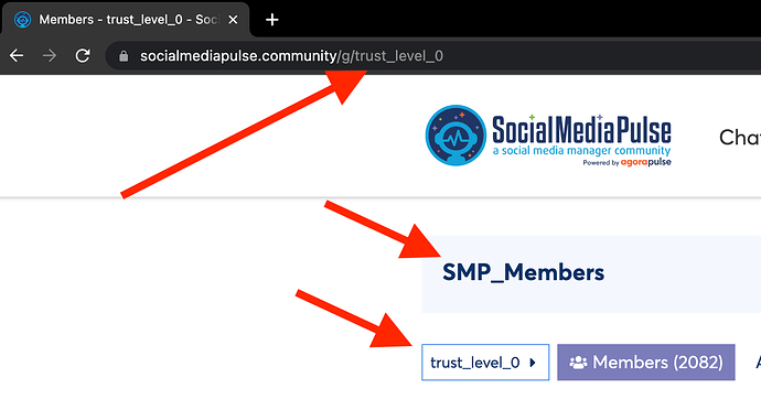

I make that change and the slug does not change:
It also will not change if I use a single word, which was successful for @Hifihedgehog.
To speed up the change throughout all the menus and addresses you can manually run Jobs::EnsureDbConsistency from your /sidekiq/scheduler page :+1:
Ok, so, if I don’t, the job will run at some point and make the change?
Next time it’s scheduled to run it should make those changes just as it would if you triggered it manually.
This did successfully run overnight after we spoke about this – thank you, @JammyDodger
Thanks for mentionning. Indeed, the modifications works after the job. I’m going to report it in the subject I have opened.
