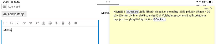

But what happens every time is when I try to change used persona. Last used is always visible. I change it and then popups this (sorry language)
It’s warning of user that has’t seen long time. But user is the very first persona I had. It is never same where I changed, but always that Deckard guy.
I close that warning, write my question and send it. I get answer, but answering persona is not what I was selected, but the last used — and in most of cases other than that Deckard. Then I make a new try, and it works.
So I have to change used persona every time twice to get wanted one.

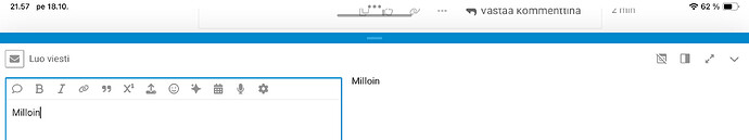

If I hide/drop down that first PM-try and open it again, used persona is missing.
