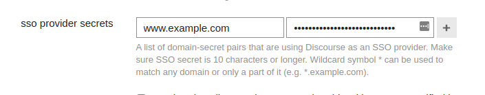

  • copy your DiscourseConnect Secret Key from WordPress to the ‘secret’ field of the Discourse ‘discourse connect provider secrets’ setting. In that setting’s ‘domain’ field enter your WordPress site’s domain. Then click the green checkmark to save your settings.
When complete, the ‘discourse connect provider secrets’ setting on Discourse should look like this (with the domain set to your WordPress domain):
Discourse should now be functioning as a DiscourseConnect provider for your WordPress site.

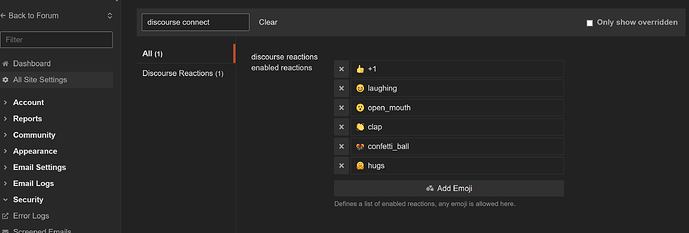

我的 Discourse 没有这些选项怎么办? :confused:
@LosHunterros,欢迎来到 Meta!
Discourse Connect 不包含在基础托管计划中
Screenshot_20240507_204846_Chrome
4 个赞
