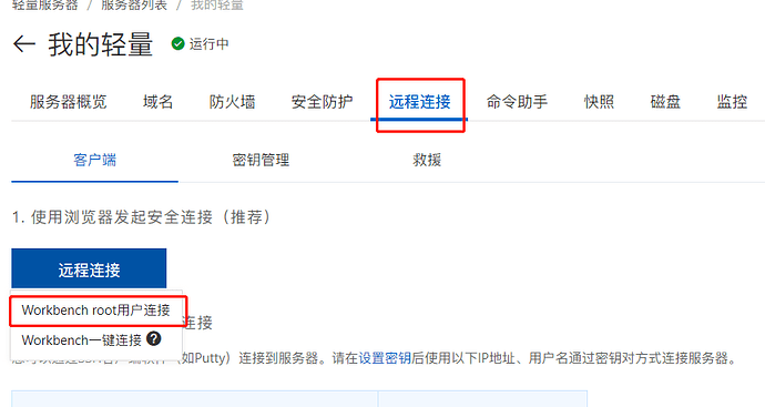

After activating a new server, open all firewall ports first (after debugging, close unnecessary ports according to your needs, leaving only the ones in use to avoid hacker attacks). Set the root password in the control panel, then directly SSH into the server via the web browser, or download an SSH client like XTerminal.
Then paste the following three commands and press Enter to execute. When prompted with options, press ‘yes’ to update system sources and install git.

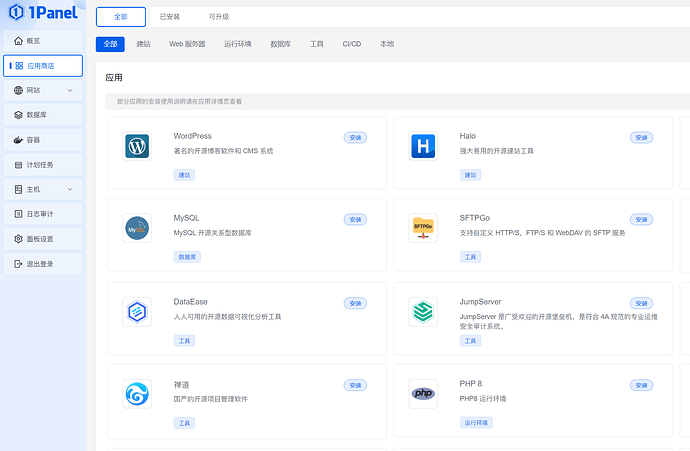

Then install a 1Panel. This step is mainly for installing other website programs and for beginners to manage easily. Compared to Baota, this panel is much simpler, cleaner, and has fewer ads. The installation speed is only a few seconds, unlike Baota, which requires long compilation times for the environment.
Execute the following script:
curl -sSL https://resource.fit2cloud.com/1panel/package/quick_start.sh -o quick_start.sh && sudo bash quick_start.sh
During installation, it will prompt that Docker has already been installed, and then display the login backend.
Follow the prompts, find the backend login, and you can see ‘app’ in the container management, which is Discourse. You can start or stop it here.

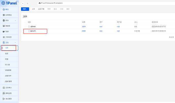

Then enter the files and edit app.yml. The main modifications are commented in Chinese.

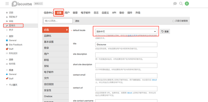

  DISCOURSE_DEFAULT_LOCALE: zh_CN

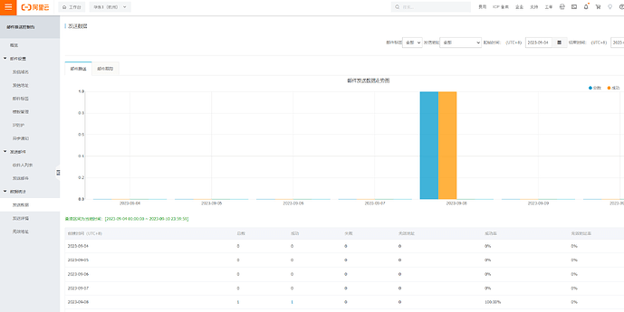

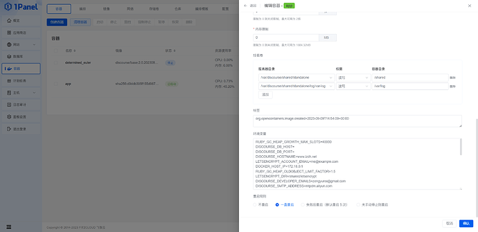

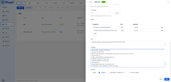

Later, when testing email sending, I discovered a problem:
The settings for these containers, editing app.yml, do not seem to take effect after rebuilding. It needs to be modified in the container environment variables. However, it only takes 5-6 seconds to take effect. It’s still unclear if it affects plugin installation.

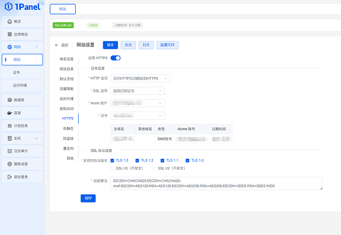

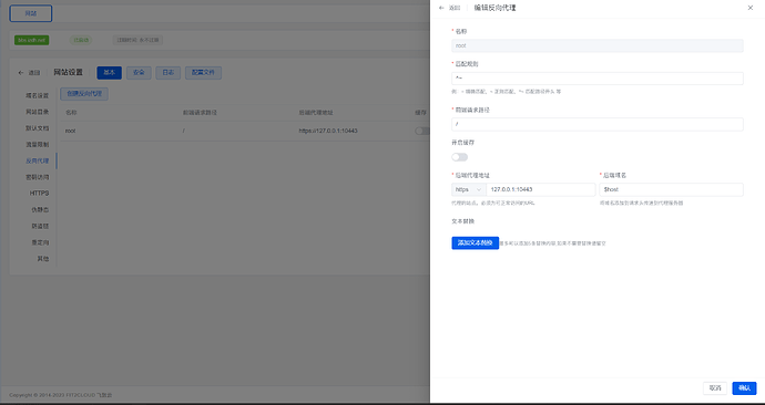

Running alongside other websites seems to involve first creating a reverse proxy, then changing the default container’s 443 port to a port like 10443, and then configuring the certificate to enable normal access.
Reverse Proxy
Configure Certificate

:sweat_smile: But editing the configuration file, I found that rebuilding didn’t work, and changing the environment variables in the container took effect in seconds, saving the trouble of rebuilding. Whether the plug-in has any effect is temporarily unclear.

:sweat_smile: I say, tinkering with the configuration file proved fruitless, as the rebuild didn’t take effect. However, altering the container’s environment variables worked like a charm in mere seconds, sparing me the bother of rebuilding. The impact on plugins remains uncertain for the time being.
Previously, I’d neglected to enter ‘sudo -s’, resulting in a barrage of error messages. I was utterly flummoxed as to the source of the problem.

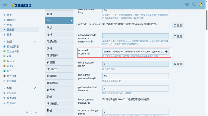

@Lhc_fl @zengyunsi Is there any way to implement forum username field protection? The custom settings only include sensitive word filtering and permitted user fields.
Support for Chinese Unicode usernames: Discourse accommodates Chinese usernames - Discourse - iSharkFly
However, what is username field protection? Does modifying a username require review?
If it’s the former, Discourse does not have native functionality for this. It is recommended to consider developing a plugin.
Alternatively, you could simply review all usernames on the site periodically to check for issues.
@go_ahead Also, I suggest opening a separate thread in English or a mix of Chinese and English to ask this question. This is because off-topic posts in the meta section will be split into separate threads.
Asking in Chinese will also cause inconvenience to several moderators who do not speak Chinese, as it is not easy for them to understand what we are discussing.
Whilst I understand your query, allow me to elucidate on the concept of username field protection and the necessity for username modifications to undergo a vetting process.
If that is indeed the case, Discourse lacks such a native functionality. I would suggest contemplating the development of a bespoke plugin to address this requirement.
Alternatively, you might consider conducting periodic reviews of all usernames across the platform to identify any potential issues.
@go_ahead Furthermore, I would recommend posing your question in English or a combination of English and Chinese in a separate thread. This approach is preferable, as off-topic discussions in the meta section are typically subject to thread separation.
Utilising Chinese exclusively may prove challenging for our non-Chinese speaking moderators, as they may struggle to comprehend the subject matter of our discourse.
I seem to have found this feature, this is it.
Alas, my command of the English language is woefully inadequate, and I find myself lacking in experience when it comes to communicating with them. I shall endeavour to be more mindful of this matter henceforth. I am most grateful for your guidance!
According to my understanding, moderators typically categorise topics containing Chinese content under the ‘chinese-translation’ tag.
Generally speaking, the issue is not particularly significant, and one could also provide an English summary beneath one’s post.
In truth, it’s not overly problematic, as moderators can utilise translation software to garner a general understanding. The matter is of little consequence.
