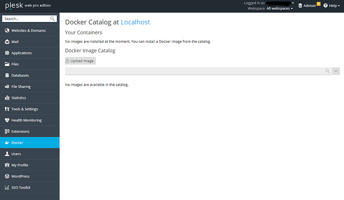

Does anyone have a ‘tried and tested’ set of instructions of how to install Discourse on a Plesk server?
My Plesk Server has a Docker option, would that help? (see image)
Thanks in advance.

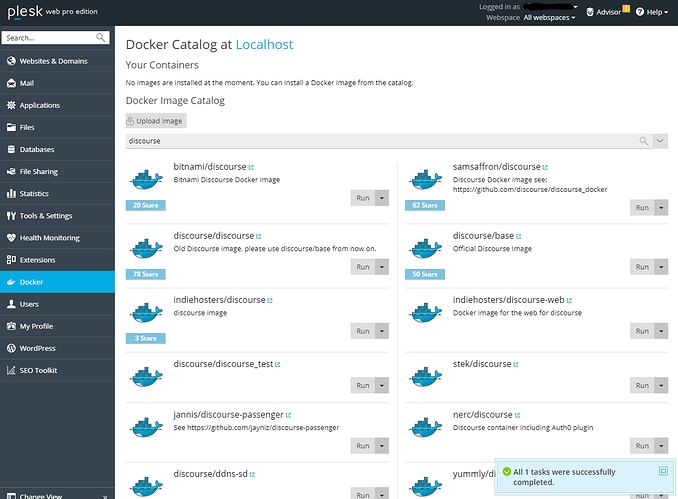

Which of these many Docker images is the best one to use? (see image)
Thanks.
The Official Discourse Image
OK thanks, I will report back my findings for the benefit of others.
And that is what you can expect as you do the same.
The one that you build yourself with launcher.
