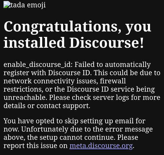

I also wasn’t sure if I was supposed to comment out the ports so I tried again without doing that and now it’s working… A little bit because this doesn’t look right
I disabled Rocket thing like the guide said as well. Issue happens on both domain and on localhost
Looks like a CSS problem, as well as a firewall problem? Do you have any firewall restrictions on your ISP?
Haven’t setup any firewall restrictions and haven’t touched the CSS either. The router I’m using is also very limited so I’m not able to change any firewall settings unfortunately.
Also, apparently there are no ports restricted except Port 25 and 455
Also looks like it’s not using HTTPS but HTTP instead for some reason. Like the guide said I did force HTTPS in the app.yml so not sure why I can’t access the site then using HTTPS
