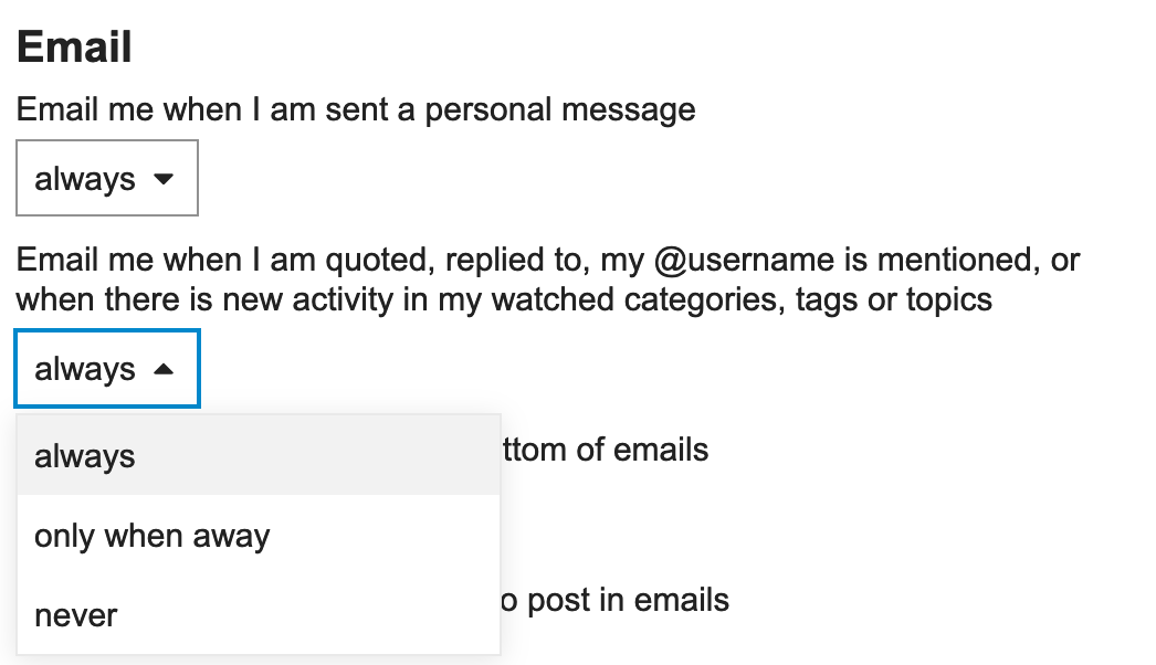

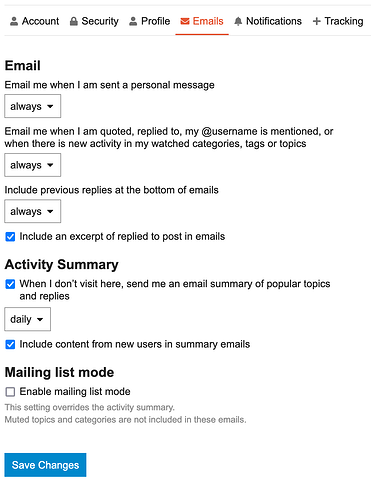

There is an option for mailing list mode that will send all new posts as e-mail. The settings can also be adjusted for individual notification types to always send e-mail instead of the “only when away” e-mail setting which may mean away for ten or more minutes.
However these settings are on the user not admin side, and would not work if a user has muted a topic or category then no e-mails will be sent for those.

As @anon65426961 noted, users can set an option so that they are always emailed, even when they are active on the site at the time the email is created. By default, users will have the option set to be emailed “only when away.”

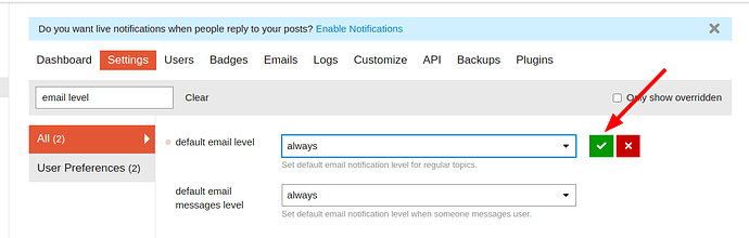

You can use the default email level site setting to update the email option for all users on your site. To do this, change the setting from its default value of “only when away” to “always.”

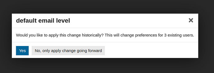

After clicking the checkmark button to save the setting, you’ll be asked if you want to apply the changes historically:
Click the “Yes” button to update the option for existing users on your site. Otherwise only new users will get the updated value.
