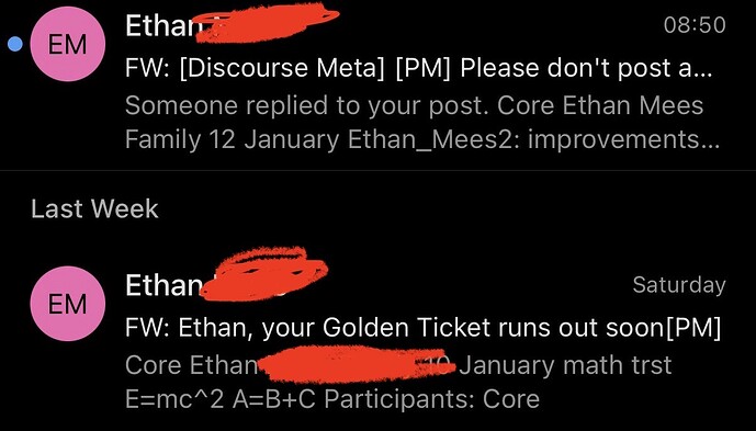

For reference, this is how the new preview text is surfacing in Outlook for iOS for me - it’s not just an inbox snippet; it becomes the first visible line associated with the message, which is what users are reacting to.
This seems consistent with %{email_preview} being added recently: even if intended as hidden preheader text for HTML emails, in practice it’s highly visible to users (at least in some clients / delivery paths), which explains the sudden complaints.
