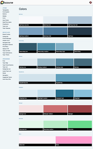

:flashlight: You can see all of the available variables for use in your SCSS files if you click on the Style Guide link while previewing your theme on theme creator, then clicking on Colors in the left hand menu.
The Styleguide is a very helpful section to look at when you are creating a custom theme. Each Atom will show you how certain elements of Discourse will look with your styles applied.

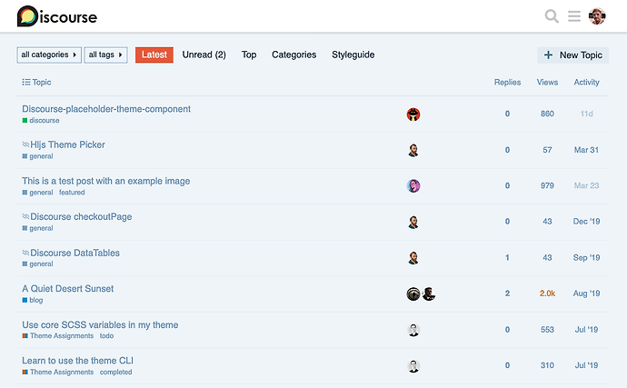

With the previous section under our belt, I think it’s time for us to go a bit deeper as to what can be done in Discourse with only SCSS. (Hint: A LOT!)
Styling the Header
You will notice that our previous changes to the color scheme have left something to be desired with our header. The icons are barely visible!
The Discourse Header includes a container (with a background color) to hold a site logo, as well as the nav icons to the right. All of these can be customized.
The target class to customize the header is .d-header.
In our common/common.scss file, let’s add the following:
.d-header {
  box-shadow: none;
  border-bottom: 1px solid var(--primary-low-mid);
  height: 5em;
This will remove the default box-shadow on the header, give it a little more height, as well as set a border-bottom to give us some separation.

This is looking good, but a keen eye will notice the increased header height has given us less room in between itself and the rest of the Discourse forum elements!
The spacing between the main area and the header is controller by the #main-outlet target. Lets increase this spacing just a bit by adding the following to the bottom of your common/common.scss file.
#main-outlet {
  padding-top: 6.5em;
Navigation Container

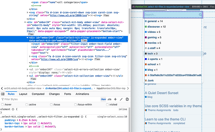

If you look closely, you can see our changes have left a small border visible at the top right of the search area.
Lets fix this by looking in our browser’s inspector. This is always a super helpful tool to learn what classes/IDs we need to target in order to apply styles correctly.
With the dropdown menu visible, right click on the search area and ‘Inspect’ the element in your browser.
We can see that this input is located inside of a div with a class of select-kit-filter.
If we look at the rules being applied to this selector, we can see that it currently has a border-top and bottom, as well as some padding applied. We want to only change the border-top styling.
Add the following code nested in the .select-kit-body scss from earlier.
.select-kit.combo-box.category-drop,
.select-kit.combo-box.tag-drop {
  .select-kit-body {
    // ...previous code
    .select-kit-filter {
      border-top: 0px;

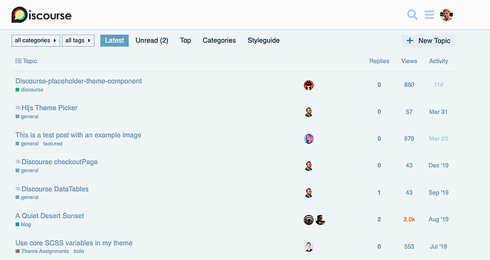

Navigation Links
Let’s add some styles to get these navigation links looking similar to this:

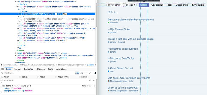

Let’s use our inspector again to discover what we should target here.
We can see that our navigation elements are inside of a UL with a class of "nav nav-pills ..."
Back in our common.scss file, under the previous section, but still nested inside of navigation-container lets add the following:
.nav-pills {
  & > li a {
    &.active {
      color: var(--tertiary);
      background-color: var(--secondary);
      border-bottom: 4px solid var(--tertiary);
This change will target only our links with a class of active that are children of nav-pills. This change should get our active link looking like so:

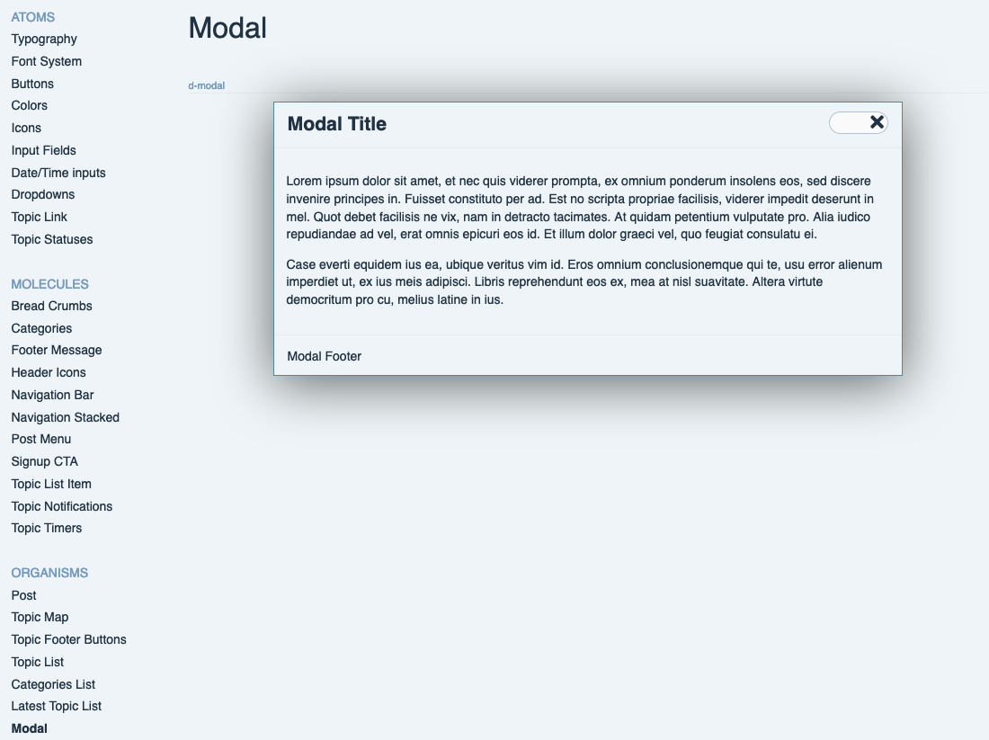

Buttons in Discourse come in many shapes and sizes. You can view an assortment of them in the Style Guide in the Buttons section.
I would like to change most of the buttons on this theme to be rounded with some custom styling. This will change the + New Topic button, as well as other buttons throughout the site.

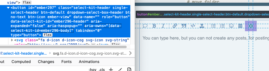

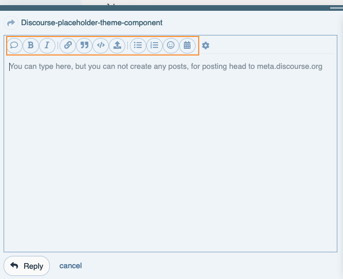

Now that our buttons are styled, I’d like to point something out about button styling and why it’s important to test all of your designs.
Go ahead and click through to a Topic on your site preview, then hit the reply button on a topic reply, or from the reply button at the bottom of the topic stream. You will see that our button styling has affected some things we may not have had in mind.
I do not want these text-editing buttons to be affected by my previous styling. This requires a bit of more complex SASS/CSS, but we can get our code to :not() affect these buttons. :wink:
Lets add this line of code, in front of our current .btn target. This will tell our styles to only apply to buttons who are not children of the .d-editor-button-bar.
:not(.d-editor-button-bar) > .btn
Ok that worked great… but wait! Now there is this strange rebel doing it’s own thing.
Inspecting this in the browser, I can see that this button has a class of .select-kit-header because upon clicking this gear, more options will show up.
:flashlight: I can not stress how important using your browser’s inspector tools are when creating Discourse Themes. They are your best friend to ride with you on this journey.
Now that we know we DON’T want to target this button, let’s add some more :not() functionality to our code.
.btn:not(.single-select-header)
This will select all buttons that are NOT children of the .d-editor-button-bar and do not have the class .single-select-header. I know this is a little confusing, but inside Discourse, there are many moving parts, so sometimes the styling needs to be very specific for it to affect elements correctly.
I have also noticed that our current styling affects the modal close button awkwardly. Clicking on anything that pops open a modal would allow you to see this, or even easier, we can navigate to the modal section of the Style Guide.
To fix this, I will add another target to our code.
.btn:not(.single-select-header):not(.modal-close)
