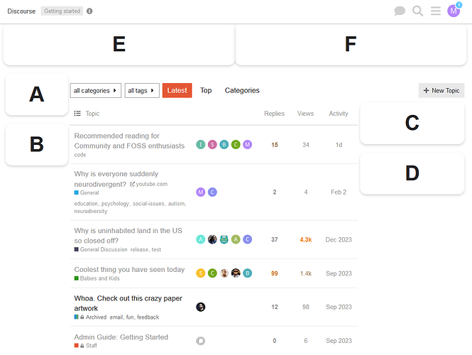

  • It comes with existing example settings that show some big letters, partly as a demo and partly so you can see example settings. Delete these and replace with your own Component names.

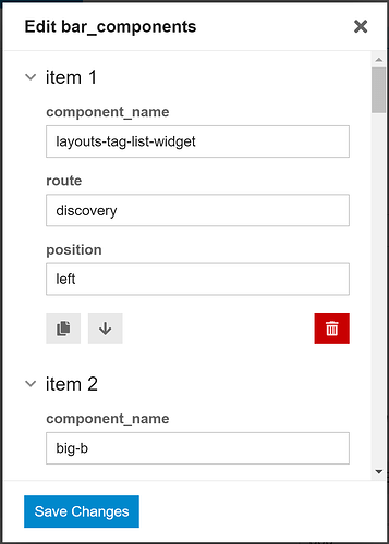

This looks awesome - Thank You! Could you please provide an example for what the settings look like for including the Tag List Widget in one of the sidebars?
For example, from the instructions it seems this should work…
But the left sidebar still only shows the big-a…

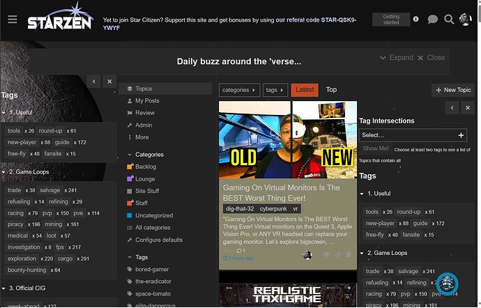

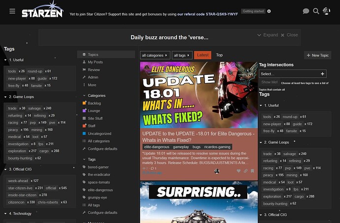

First, here are similar settings from StarZen:
The component name is in fact the same as the file name in the Component (i’ll add that to the OP)

Yes, I did the double Save :slight_smile:
Still, I must be missing something because the result is the same. Is there something else I can provide to help?

Your component_name is still wrong, see my example and you might want to delete the rest.
Hmm… OK I deleted all but the first one, and changed the name to match yours (even though the component name is coming from the TC GitHub - paviliondev/layouts-tag-list-widget: The Tag List Widget allows you to display tags from Discourse in a sidebar using Pavilion's Custom Layouts Plugin. - where would I find that the correct component name is layouts-tag-list?)
However, changing the component name in the modal doesn’t seem to change it in the settings json, or remove the rest of the items, even after double save…

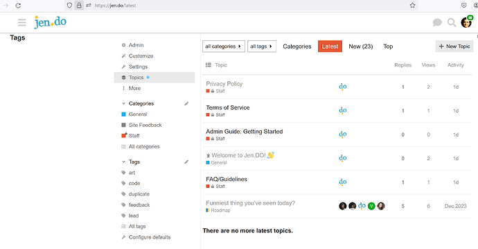

In case it’s helpful, I did discover that, with the same settings as above, while the left sidebar is not appearing anywhere else, it is showing on the /latest route (albeit only the title “Tags”, without showing any tags.)
