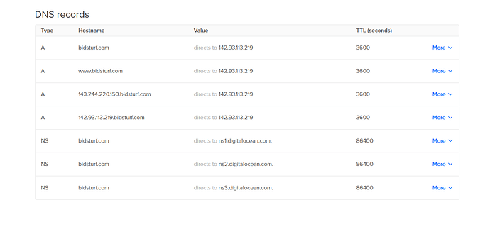

These are the records I have in DigitalOcean, do I need to set this up for the site to work?
I think you should only have the one A record, but apart from that your dns is resolving nicely when I check https://dnschecker.org/. :partying_face:
I’m not sure what the bottom two A records are for, but I think the www should be a redirect or a cname rather than an A. There’s also some advice on getting a certificate for the second domain as well Set up Let’s Encrypt with multiple domains / redirects
However, you may find it simpler to concentrate on getting your site set up on one first and sort out the second address later.
I went to Godaddy support for the two bottom A Records. I put two because I didn’t know what IP to use.
I opened CMD and pinged the website and got the 143.244… IP address as hostname and added it as A record. The 142.93… one is the VPS IP address.
I don’t which one will work, just trying to display the forum at bidsturf.com ( which still doesnt display at the moment).
But I will perhaps try to remove the 2 bottom A records and add the www as a CNAME.
If they’re added on the advice of godaddy to help sort out the original issue then double check the advice just to make sure it’s entered correctly and leave them in for now. :+1:
Just to confirm, the IP the ‘main’ A record is pointing to is the one of your DO droplet?
If so, I’d try running ./discourse-setup again to see if that brings things to life. :magic_wand:
