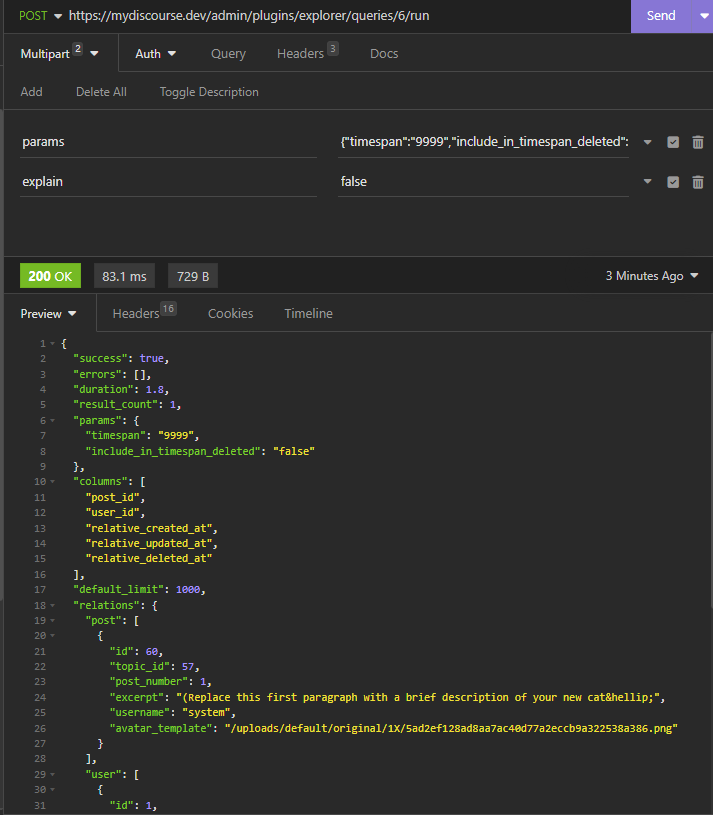

This comment seems to imply that you can do CSV export from the API. Is that possible? Just curious because I need the data as CSV. I can always get it as JSON and convert to CSV but if there is a built-in way to get CSV that would be a little easier.
Is it possible to do a query ‘like created or updated the last 50 seconds’?

Yes, of course.
You create the query in data explorer, then you run the query through the API as described in this guide.
I just ran Moin’s query via the API and it properly returned the expected results.

@blake
language python
library requests
Could you provide a API sample Data Explorer query that includes three parameters
refer
[Topic]( Passing params to Data Explorer using API requires enclosing a value ) which says params need to be strictly in double quotes
Sure, here is an example using python:
import json
import requests
API_KEY      = "YOUR_API_KEY"
API_USERNAME = "system"
QUERY_ID     = 20
SITE_URL     = "https://your-site-url"
# all values must be strings
params = {
    "user_id":   "2",
    "viewed_at": "2019-06-10",
    "limit":     "5"
# Data Explorer expects params as a JSON‐encoded string
payload = {
    "params": json.dumps(params)
url = f"{SITE_URL}/admin/plugins/explorer/queries/{QUERY_ID}/run"
headers = {
    "Api-Key":       API_KEY,
    "Api-Username":  API_USERNAME,
    "Content-Type":  "application/json"
r = requests.post(url, headers=headers, json=payload)
r.raise_for_status()
print(r.json())
