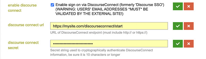

Enabling DiscourseConnect
To enable DiscourseConnect you have 3 settings you need to fill out:
enable_discourse_connect : must be enabled, global switch
discourse_connect_url: the offsite URL users will be sent to when attempting to log on
discourse_connect_secret: a secret string used to hash SSO payloads. Ensures payloads are authentic.
Once enable_discourse_connect is set to true:
  • Clicking on login or avatar will, redirect you to /session/sso which in turn will redirect users to discourse_connect_url with a signed payload.
  • Users will not be allowed to “change password”. That field is removed from the user profile.
  • Users will no longer be able to use Discourse auth (username/password, google, etc)
